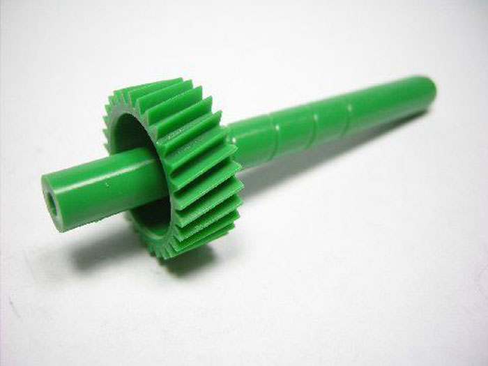

Anyone know which teeth combo could work so the dash speedo will show the real mph?
Thanks, really helpful.
It's definitely not take 2000 pulses and take away tire diameter difference of 7.65%.
153 pulses
11 and 29 would be close for stock tire size.
11 and 27 for a 28" tire.
Awesome info, thanks guys, I'm sure this will help many others throughout the years as I didn't find posts like yours in the search.
I ordered the 27 gear for my 28" tire for better dash speedo readings and I'll burn 1806.5 pulses into ECUGN for the more accurate mph logging.
Just to state for clarity, if you change to a 27 tooth driven gear, change the ecugn back to 2000 pulses per mile.
