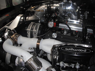

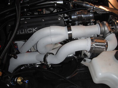

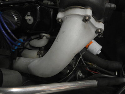

Here are some pictures from my build that were lost .

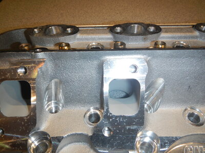

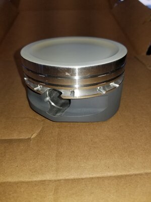

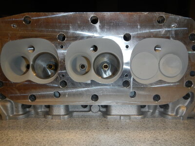

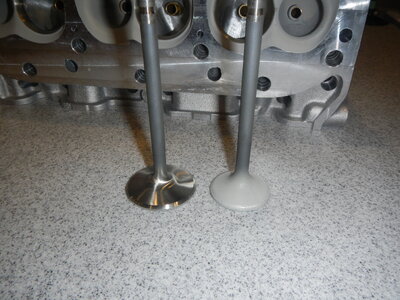

I had my headers , crossover & down pipe coated with White Lightning then VHT painted light grey . My pistons were coated with a TCB on top and PC-9 on the skirts . the combustion chambers , valve faces , back of exhaust valves & exhaust ports were coated with TCB .
The coated headers & down pipe were done a few years ago and look pretty much the same now and do not radiate the heat like they did before . That is why I didn't hesitate to try coating the main components of the new motor ..... to keep the heat in the exhaust and not in the piston tops or heads for a faster spool . DSCN0644.JPGDSCN0650.JPGDSCN0651.JPG

I my case , most the coating was for keeping the combustion heat where it belongs . No hot spots on pistons or in the chamber of the aluminum heads to help protect from detonation . I just followed the path from chamber to down pipe as far as high temp coating goes . The piston skirt coating was for any piston "rocking" in the stroker motor to protect the cylinders .
