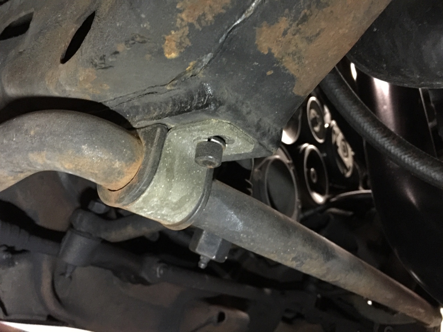

Here's my solution. Just took it to a welding shop and had them weld a couple of steel plates over the original holes. Then I drilled and tapped them.

Yours looks like such a neat,perfect fit. I can't even get the cap to sit on the frame. Something isn't right.
Sent from my iPhone 6+ using Tapatalk.[emoji252]
Best solution, would also work for the larger diameter swaybar and clamp as pictured.
