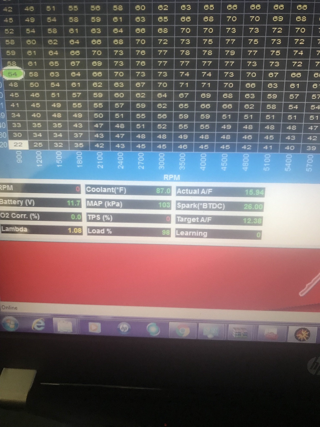

Symptoms of map problems
I don’t have the xfi tied into it at all. I bought the Casper’s xfi map adapter. I’m sure I’ve got something stupid done here

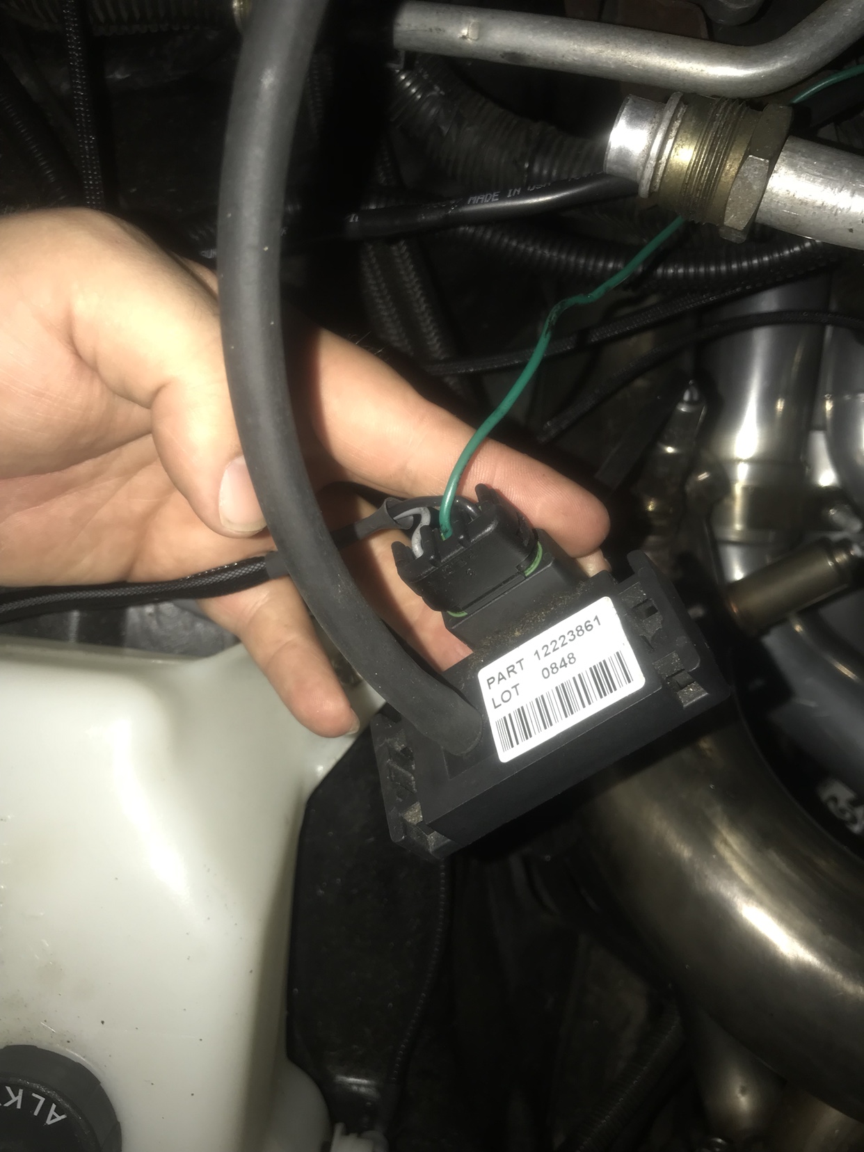

the map adapter that ties into dash harness connector uses the oe plug under hood which now has no sensor so how could that work?
options are run wire from alky harness green wire to the oe plug and splice into green wire
or move sensor back to fender and oe plug and splice in green wire to alky controller (remove the tps harness thingy)
or move sensor and tap into green wire at map jumper under dash and run to the PAC controller so both xfi and alky have a map signal
or install another 3bar rmap sensor at the fender for the xfi

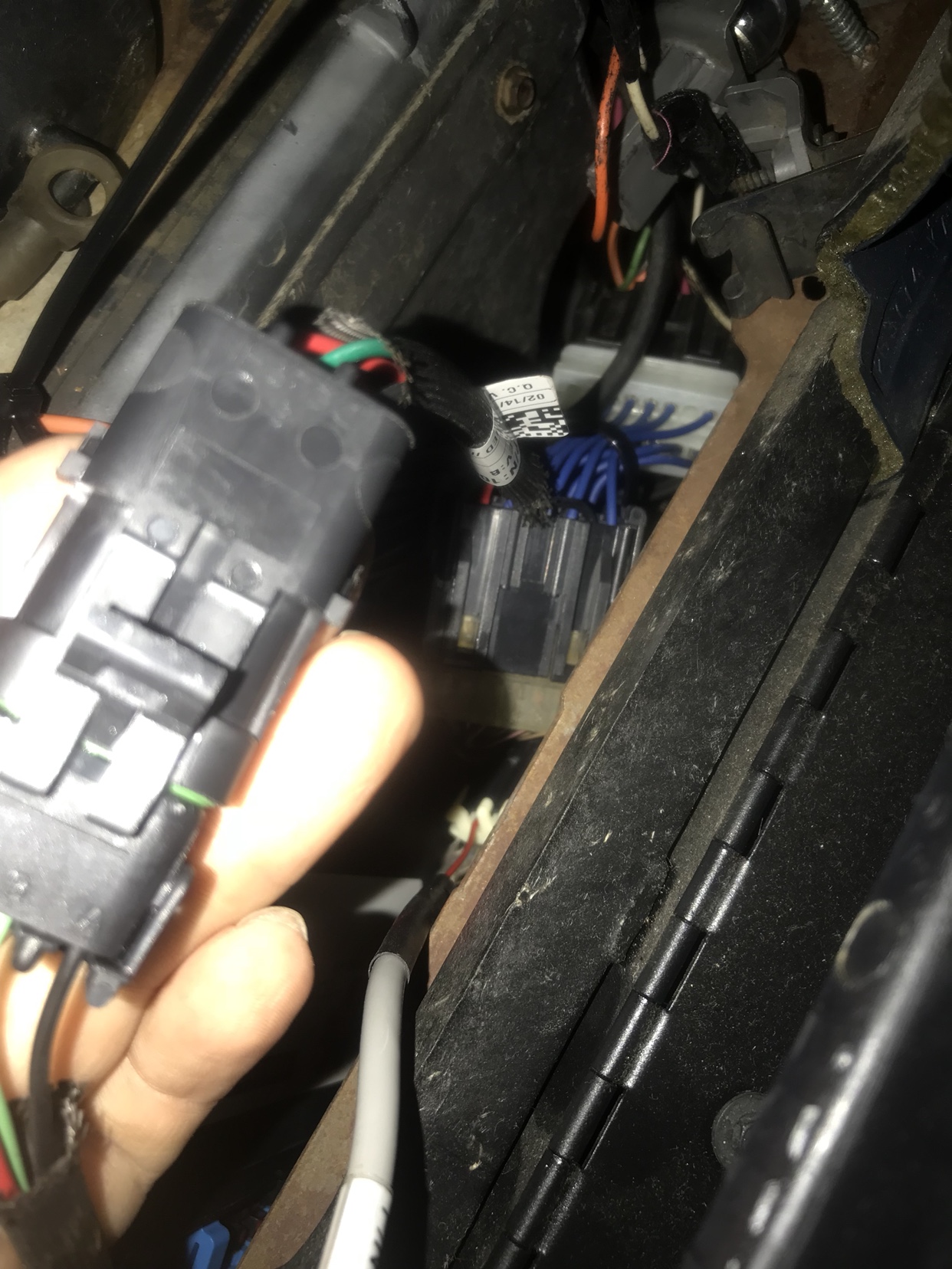

Pacecar, are you saying I still need to run wires to the 3 bar from under the passenger kick panel?
that XFI map jumper under dash makes the OE map connector under hood by fender live and connected to the xfi ,,but you dont have a sensor in that connector you have it on the alkycontrol connector
you need to get a map signal into the XFI ...
there are many ways to do this in addition to what i suggetsed above you could also just unplug and eliminate the XFI map jumper harness under dash and just run a wire from the the green wire from alky connector (or at pac box ) to the XFI casper adapter box map connector green wire that is in your last pic
another alternative under hood is run the green wire from alky connector to the OE maf connector center pin and then the xfi will get its map signal through the oe harness since casper has the maf and map wires connected in the adapter box .
Finally I understand! Sorry I’m retarded lol! You are saying they the stock wiring that has been bypassed bu using the alky connectors needs to be giving signal to the xfi. While it is unplugged it will not work unless I use one of those other methods! Lightbulb moment! Sorry for that! Thank you very very much! It all makes sense now
