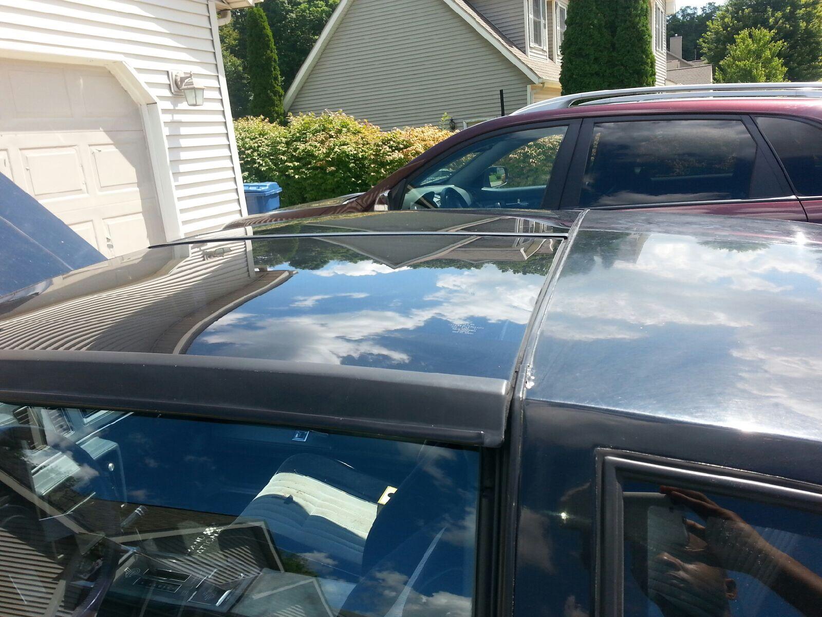

I got this pic with the TTops on. Is it normal for the center strip between the two pieces to be wavy like it is in the pic?
The main thing is whats underneath the ttops

I would be worried about this right here:
If you see surface rust, you can bet there's plenty more. Don't get too happy and overlook things. I've done it once...on an Astro Roof car. Had to junk it 5k later.
Yes I asked about that spot and he assured me it isn't rust in that spot. I will look everything over very closely. The car has been sitting in a garage for the past five years. So it has that going for it at least.
