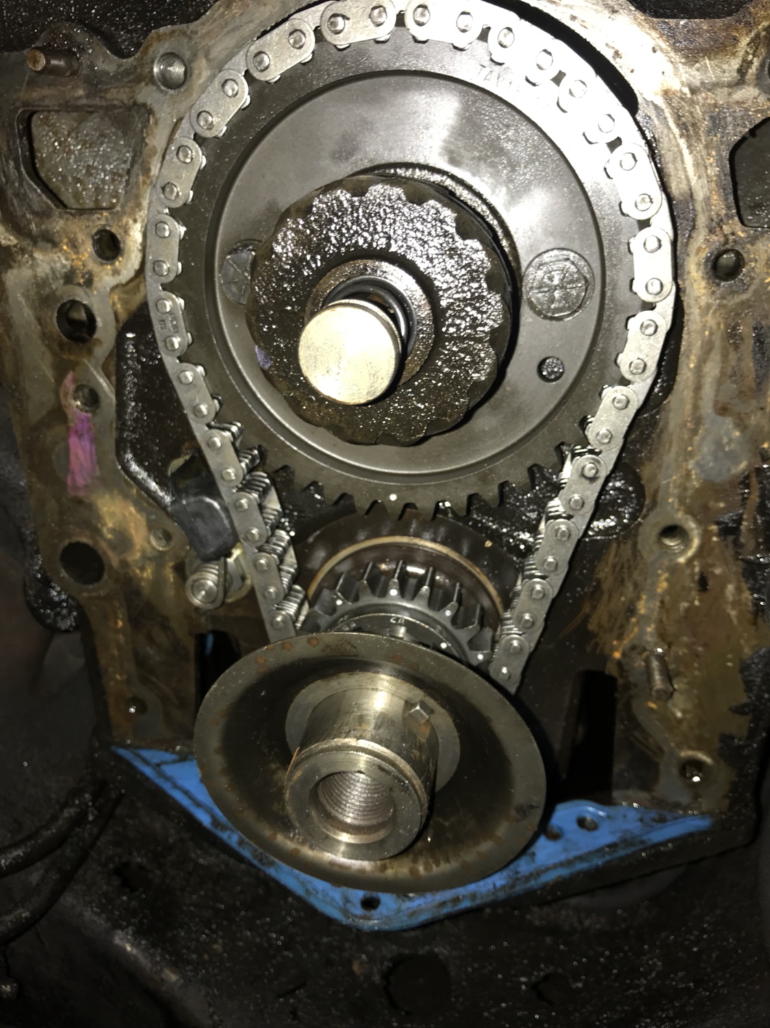

I have one of the ta performance silent timing chain sets from ta performance and am wondering the proper way to install I’ve got it all on but am confused on how to line up the dots. I have a stock untouched motor. As of right now I’m lining up 0* on the keyway but I want to make sure this is correct before I put it all back together. Thank you guys for any help.
56710dd4adb29a5f99d5bfb9dd7716de.heic
Ive installed one and remember researching the same thing. I believe 0* is correct. I may have made a post about it at the time but I bet it's been 5 years. You should be able to find the answer doing a few searches. I'll look for my old thread.
Yeah, I just wanted to make sure I was reading the old threads correctly. Thanks for your response!

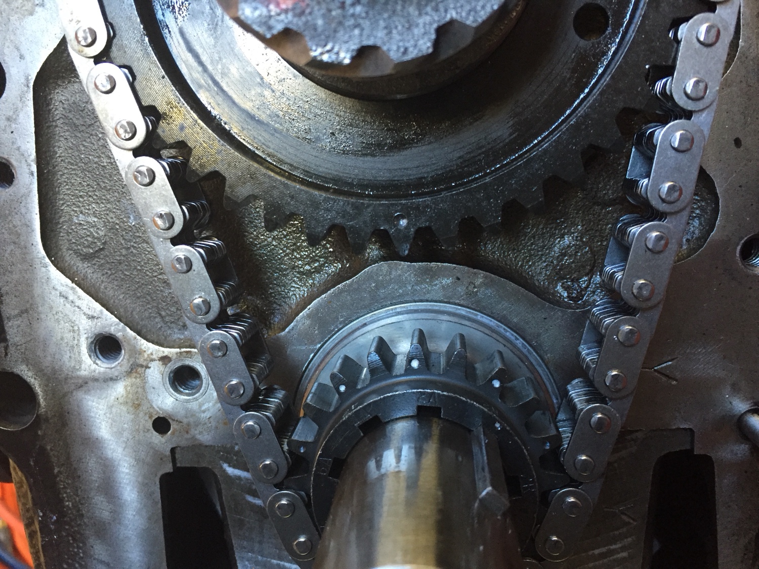

You have it correct, picture of mine at TDC .
