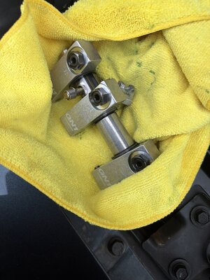

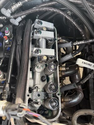

Pulling away from a light about 4k Rpm herd a noise pulled valve cover and found this.

it wasnt the rockers it was the champion aluminum pedestil that gave up , fixed a few over the years
if you ask me whats the cause its sand mixed with the alum during the pour making them weak
tap whats left in head for helicoil , chamfer the edges of the broken part and drill out any threads , thoroughly clean both parts, bolt it back down with a straight rocker shaft and longer bolt that reaches deep into the helicoil .. then weld it
alternative is what i did years ago for my GN1 8bolt heads is have champion mill them for 14bolt , this will allow you to step up to scorpion individual shaft rockers or better i went with the jesel rocker setup$$$

I noted in the photo that the broken pedestal had a helicoil in it. I think that probably contributed significantly to the pedestal failure as it concentrated all of the load in the upper 1/2” (or less) of the pedestal threads and therefore all of the load in just the top 1/2” of the pedestal itself. I measured the depth of the threaded hole and found it’s an inch deep. Ideally the entire length of the thread would have a bolt or stud engaged in it to distribute the load as deep as possible.
This stud kit from TA probably would’ve prevented the carnage.

Yup, you can tell from the texture across the break. It's really coarse. Each one of those depressions was probably some kind of contamination. The fact it failed so uniformly is a tad scary. I'm surprised that head isn't porous and leaking water through the casting wall.
