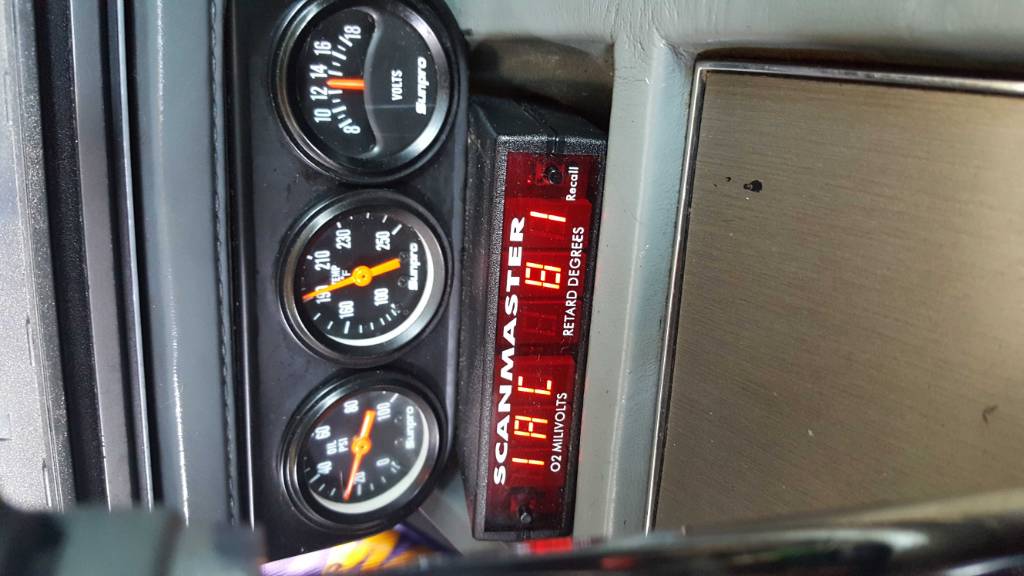

Checked the new TPS i had installed on my scanmaster it's showing 4.5 at idle and 1.28 at WOT.... car has a mild cam in it so it had a nice chop sound at idle and now it's gone and idling up too high.

Right now at idle with a warm engine and in park they are in the low 80s and have gone up to 96. I have adjusted the screw all the way out so the throttle stop plate isn't even touching it and it doesnt go any lower than that. Also my tps readings are way off... engine off and key on it is giving me an idle reading of "4.80" and when I go to WOT I get "1.28" numbers from scanmaster and verified under the hood on a voltmeter at the sensor connector

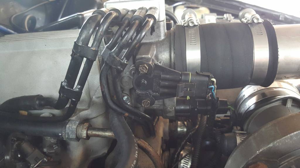

The tips should be around .42 at idle and 4.60 at wot. can you post a pic of the tps as it is now?
It ran great until it went out...
