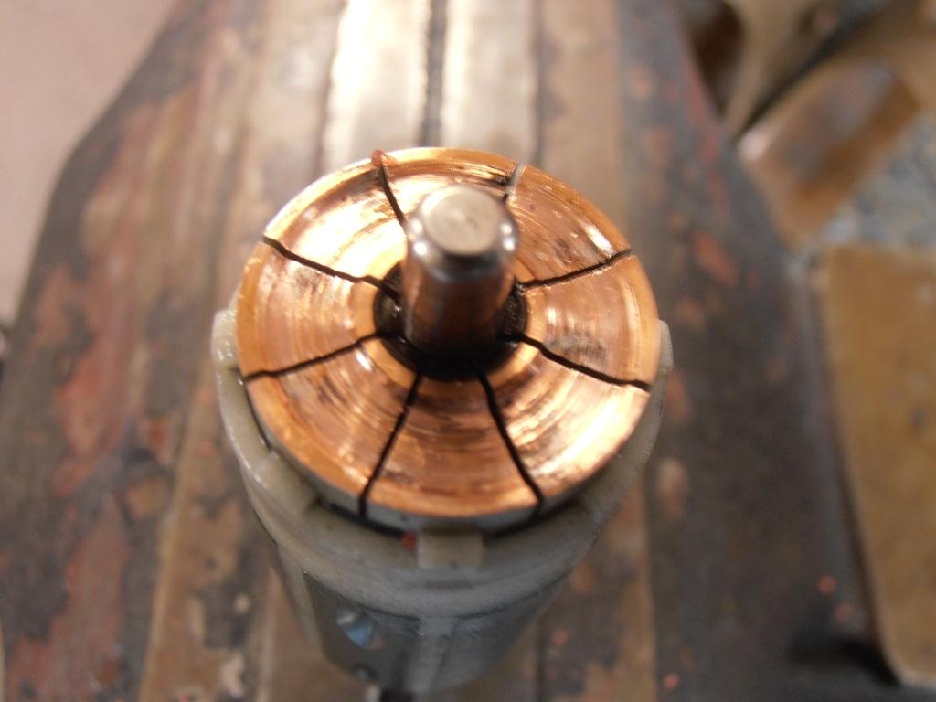

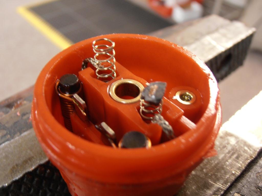

A few AM pumps have been failing mostly b/c customers do not install them properly.
The 430 and 340LPH pumps must have upgraded wiring to handle their high power demands and larger fuel lines to handle their high fuel volume.
Running these pumps on low voltage (stalling the armature) or into restrictive lines (excessive head pressure) will cause them to fail quickly.
Just recently we sent out a replacement AM340 pump to a customer so he could repair his DP before AM had the chance to evaluate his pump.
It turned out that the brushes were worn down b/c the pump had been working at very high pressures b/c his lines were excessively restrictive.
AM ended up covering his pump under warranty even through it had nothing to do with a manufacturer's defect.
We will replace any pump up front once a tech has determined that some basic pressure and voltage tests are done to isolate the problem to the pump.
We do not hand out replacement pumps as a means for customers to do A/B tests b/c they are simply unwilling to spend a bit of time diagnosing their problem.

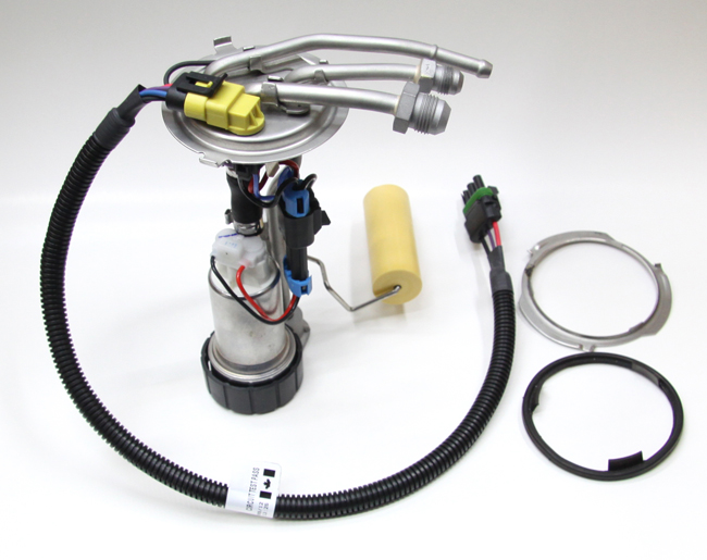

I would assume if one were to purchase a complete DP setup (with the hanger, sender, wiring harness, and everything) from R/T that it would have the wiring upgrades already installed?
Anxiously awaiting the dummy-proof teflon lines to be available to match the -8AN feed / -6AN return setup on the sender!!!
Interesting discussion! I'm sure many are watching / looking and appreciate a manufacturer's prompt responses! Damned fine vendor!
Our DP setup comes with all required wiring. It is 100% plug and play. Our line kit will be the same.
