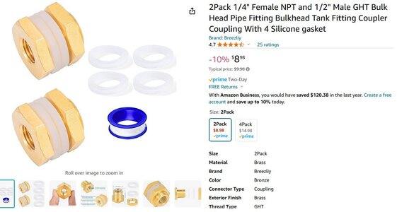

The only items you need for this is your typical wrenches of various sizes to undo/tighten fittings, a sharp razor blade, some white PTFE/teflon paste, and a step bit with a 13/16" hole option, and this bulkhead fitting from Amazon. Pic of the bulkhead fitting for searching later if the URL changes:

Step 8: Prepare your bulkhead fitting by applying teflon paste on at least the lower 75% of the threads. The teflon paste does the sealing, NOT the silicone washers. However, the silicone and teflon paste have great methanol resistance.
Step 9: Place one silicone washer on the bulkhead fitting and install it in the tank. Plop it in the fill spout and fish it around until you can pull it through the new hole and snug it up. The hole is just in the right place that it will help keep the nut of the bulkhead fitting captive when tightening down the external nut in the next step.
Step 10: Place the second silicone washer on the protruding fitting and spin the nut down. Snug the nut down with a wrench but do NOT overtighten. Tighten it just to the point before the silicone washers begin to deform and squeeze out. If you go too far, just back it off a little until the washers aren't distorting.
