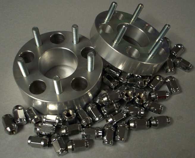

Test fit of the wheels, I'm definitely going to have to add 1.5" spacers to fill the wheel well, especially since I am putting GNX flares on, but I knew I would.

Aren't you concerned about the stress placed on the wheel bearings using 1.5" spacers? That's alot of leverage on the spindles and axles.

No not really, the new type of spacers are balanced and precise, plenty of people are out there using them with no issues. I mean, ideally I would love a wheel that didn't require spacers, and these technically don't, but I'm not too worried about it.

ive run 1.25" adapters on my rear of my GN for years now and have never had a bearing issue, no worries. Car is looking great man, can't wait to see it all together.
