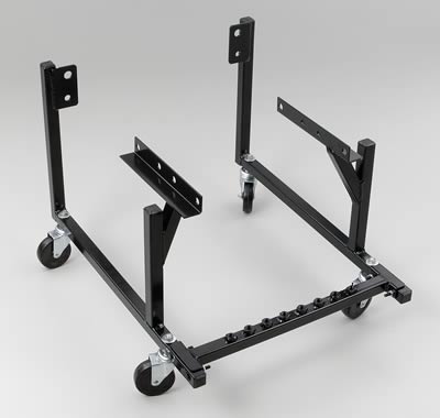

I want to store a turbo 3.8 engine in the corner of the garage and would like to buy a suitable engine cradle/frame with wheels. All I see at places like Summit Racing and Jegs are cradles made for V8 engines (like Chevy and Ford).
I am unfamiliar with the engine mount locations on the Buick turbo V6. Are they in the same location as on a small block Chevy?
I know the lower bellhousing bolts are in the same location... but I'm not sure about the motor mounts.
Looking at the Pontiac stands here: http://www.summitracing.com/parts/SUM-G1065/?image=large, I think our Buick V6's may fit... or at least be darn close.

Thanks for the wooden construction advice. That's an option. I'd still like to buy a steel one though. These '89 Firebirds came with small block Chevy 350's as well as the 3.8L turbo engine of course. So it seems like that is a strong indicator that an SBC cradle could be used. Maybe I should take this question to the Turbo T/A section.

make one- either make one out of some 1" square tubing, or modify a readily available (and cheap) small block Chevy one to work with the different mount locations. as already stated, the lower bellhousing bolts are in the same location on a Chevy V8 and Buick V6, so it's just a matter of modifying the front "arms" on the stand that bolt to the motor mount boss on the block.

Thanks A.J. You have the answer that I was looking for. Though the price is a little steep, that's what I need.
I measured up the engine mounts on a Small Block Chevy vs. my 3.8 and there is no compatibility.
