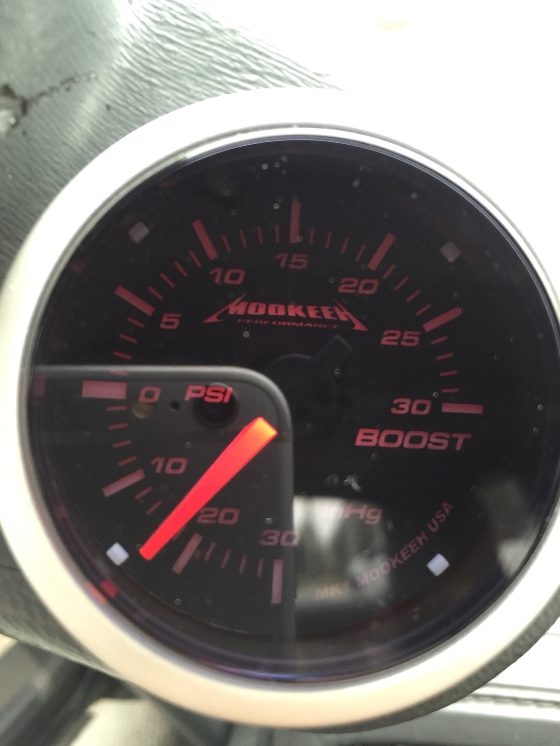

ALL Vacuum lines have been changed within 2 months. My boost/vacuum gauge is only showing -8 at idle in park??? The car does have a little larger than stock cam and ported stock heads. Need to know if this is WAY low and if so what do I look for now??
I'm not 100% sure but that's fairly low. I would look for vac leaks. What was reading before switching lines? I've been contemplating putting a smoke machine on mine as well..

Its low. If you're using that nylon vacuum line that come with most gauges that's where I'd check first.

changed line sizes on my boost/wastgate to a little smaller and tighten everything up better with new zip ties and now I'm at a better -11 vaccum. Went from -7 to 11.

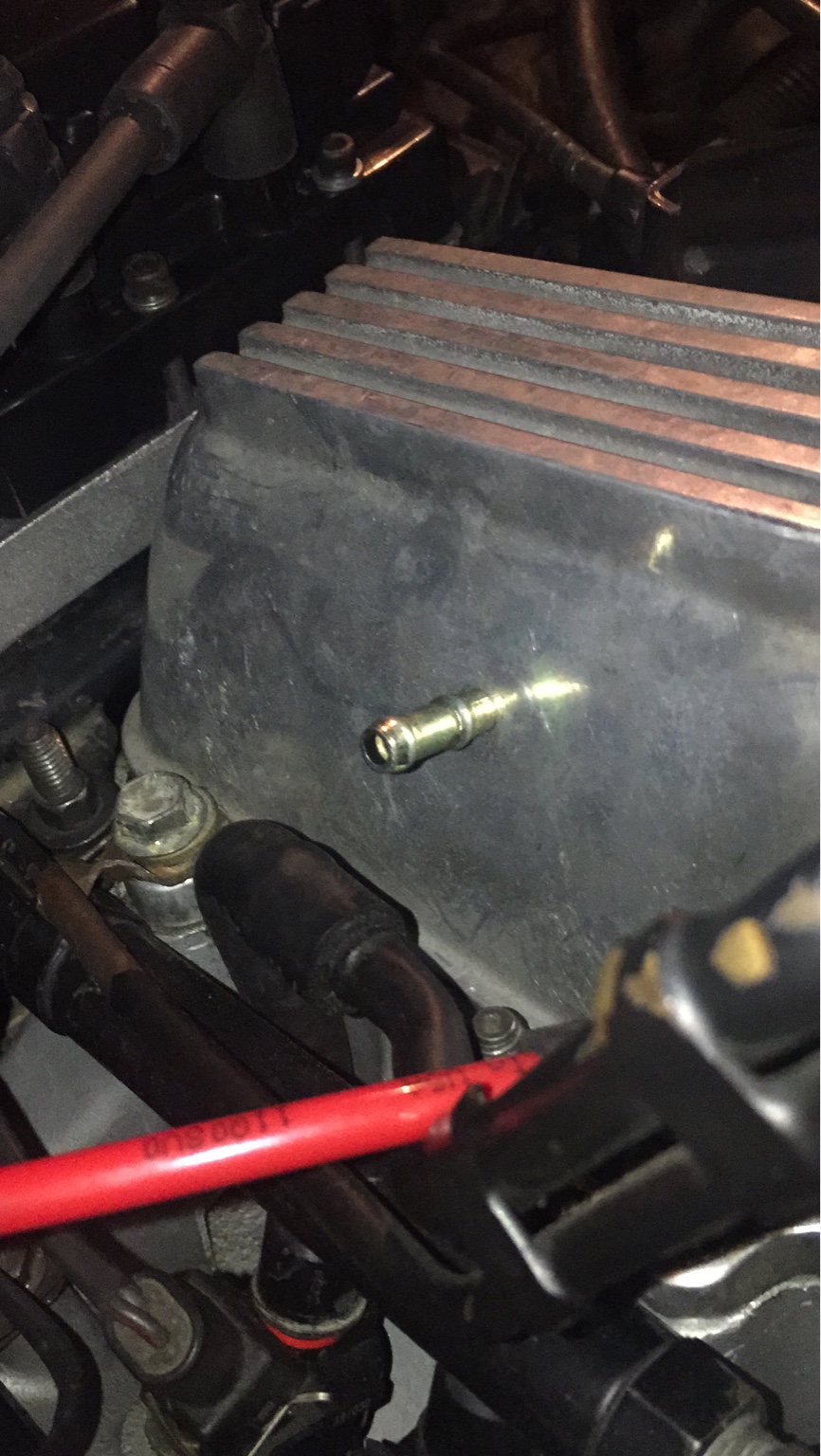

Is that gauge mechanical? If elec, is it reading from a MAP sensor, or pressure transducer?
Fresh 109, 206/206.......18" at 850 idle.
My gauge? Mechanical... Off of a tap that was put into the intake manifold.
