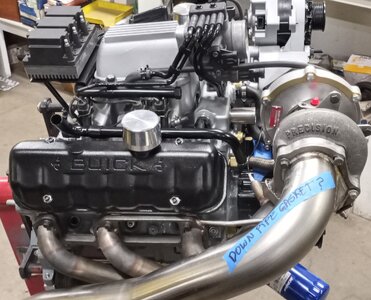

Pic of 500 piece puzzle as of 10:00 last night.
Gonna do wires,, small details, and prelube today, get it in the car over the weekend, then do the 70 mm TB, and my custom inlet/air cleaner piping. The A/C compressor is due in Friday.
