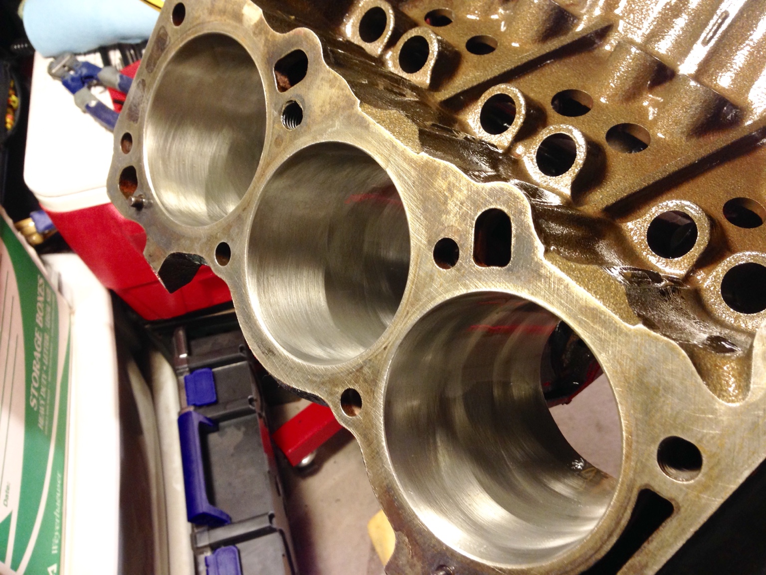

Any idea what the last stone used in honing process was? (and if you have moly rings?)
It might be the picture but that finish looks a lot rougher than I usually like.
That hone job looks crazy. What's up with that hole being threaded all the way up? Helicoil?
I don't want to hijack this thread, but in the interest of public information, (because I hate reading threads when something interesting comes up and no follow up occurs) the cylinders were smooth. The HD setting on the iPhone was pretty amped up to show more detail on the cross hatches. I would've flipped out if it was rough.
Top near middle of the picture? It was already like that when I tore motor apart. No idea. Last three previous owners?
