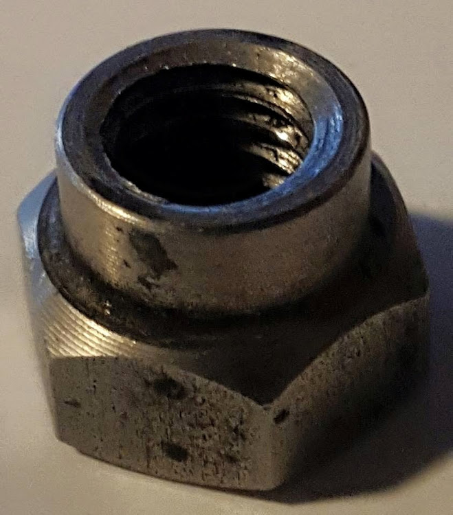

Does anyone know of a place that sells these types of hex collar nuts? 3/8-16
They were sold as part on an electric cut-out kit, but I've lost a couple over the years. Since the studs are recessed in the cut-out, they must have threaded sleeves.
Appear to be custom for the cutout. McMaster-Carr carries 3/8"-16 'coupling nuts' that are 1-3/4" long with a 5/8" hex. If you know someone with a lathe easy enough to create the collar. Due to the length should be able to get two final pieces from each coupler.

they looked to be fine thread on ebay but description says they are too lazy to take a pic of actual nuts you want :LOL:
