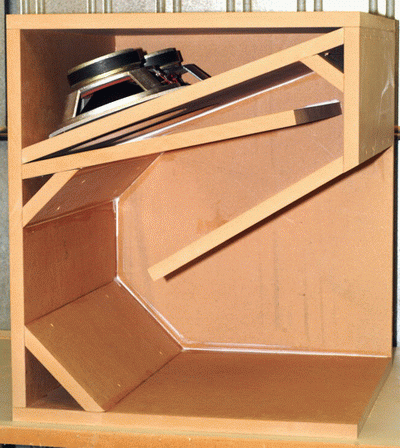

I googled these to show the inner workings so that you can see that it is more than just a rectangular box. Folded horns are the epitome of 'OLD SCHOOL' and in the trunk of a Regal it would truely be different.

83 Cannon, I understand what you want. There is nothing different about what you doing though. Whats so different about putting two bigassed subs in a bigassed generic pre-fabbed box? Many many many many many many many people have been there & done that. There is absolutely ZERO ingenuity involved in that approach. It would be 'fun' as rubbing babyoil all over J. Lo's NEVERMIND. Sorry I kinda got a little carried away. Butt in the way of originality and uniqueness it simply won't be. The only problem with that is I keep seeing you post about wanting to do something DIFFERENT. You want different, I'll give you different. Since you obviously are comfortable with consuming your entire trunk with subs, consider this. Build an 18" 'Folded Horn' sub enclosure in your trunk. You'd never miss another note with bass response reaching solidly below 20hz. Unique? Yeah I'd say so.

Smh...anyway Wendy, that's about exactly what Im talking about in those pics. The first box I love because it already starts the process in reverberation and by the time it comes out...it mimicks how the sound would be if a traditional dual sub box was in a trunk and the car had passed already and the sound was deeper.
That second configuration looks just like trouble. I can almost see that bass churning out of the maze and releasing into something that sounds soft yet very effective to a nice Jazz musician.
The third is one that I have seen before...I knew a guy that installed car audio and had a sub box with 4 15's and the box looked like a wedge of cheese. The subs put out so much pressure but the barely moved at all. I believe he used two Intefire IFC??? Amps. They were strong I do remember that!
