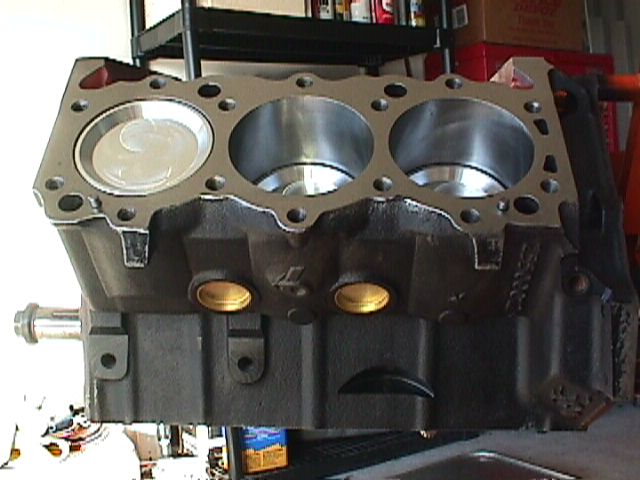

4.1 here's my pic, not the average 4.1 block i like many built her to run 9's safely. i only have one pic.

Looks like someone added some extra bolt holes. Look at the far side, you will see the welded on tabs.
Usually one will add the RJC head clamps to the outer side.

That don't look like a 4.1 block. There's too much meat between the cylinder bores. It may be because it was decked. It sure has the coolant holes though.
I don't think the production blocks (3.8 or 4.1) have bridged water passages on the end of the deck. Looks like a stage block to me.

Looks like a 3.8 #0012 stage1 block. Let me know if you want to sell it if it is a #0012.
