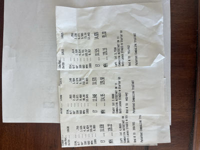

I took the plunge and went 6062
Think I have 7 passes, very happy, in Phoenix firebird park.
Think I pushed the intake gasket and made a milkshake on the last pass.
came back to the pits with good temp and oil pressure running and idling just fine, but I raised the hood to look things over and it was not pretty.
But here are the 3 out of 4 tickets (lost the first) low 11 with tire spin. the rest in the 10s

Nice I have this in my Talon and it's killer.
What rpm launch and psi?
What total psi?
This is a possible low 10 turbo with tweak to your 60ft, wow.
New converter? or the same as old combo?
10 lb leave 3600-3700 through the traps at29 lb trying to find a external waste gate to control the boost better Patiently waiting for TA
Thanks MPH is up 2mph locking converter and yes new converter
