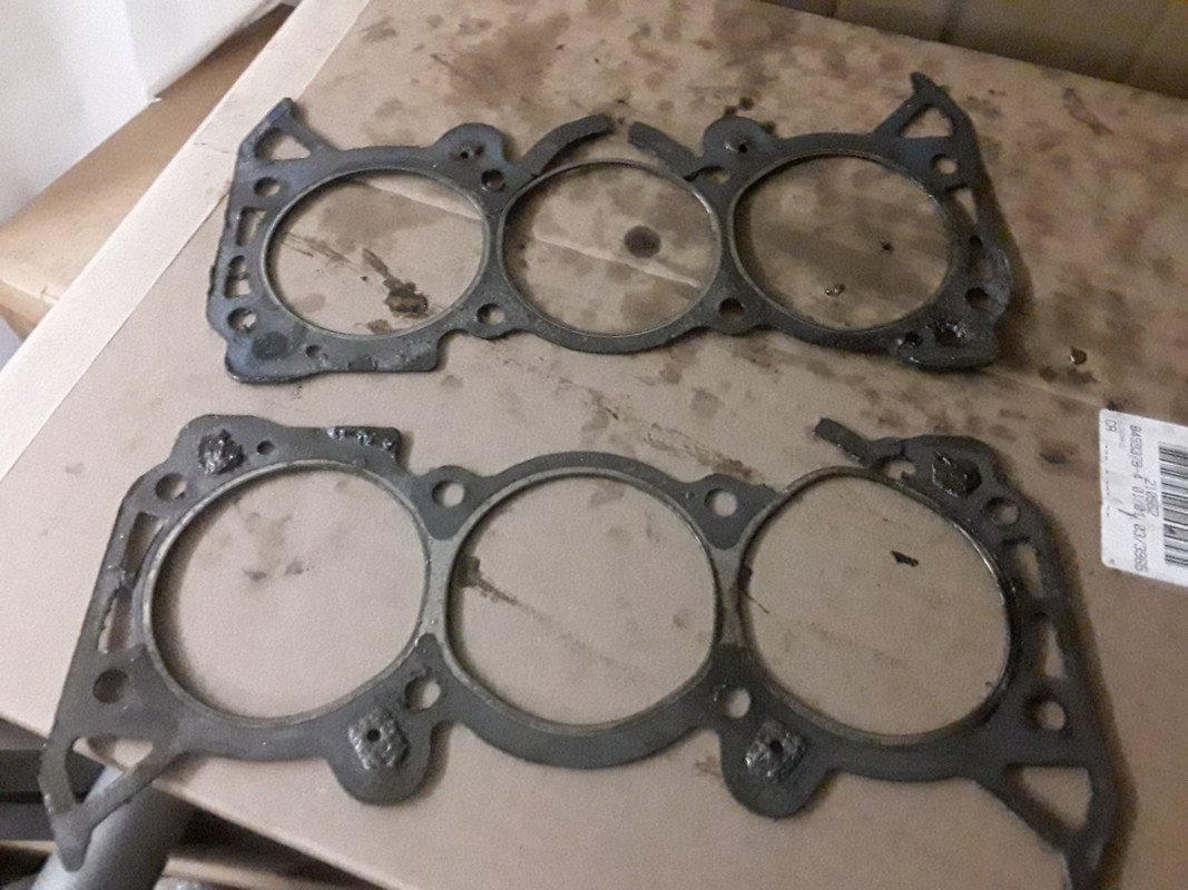

Pulled the intake clear as day you can see a torn/ripped head gasket.

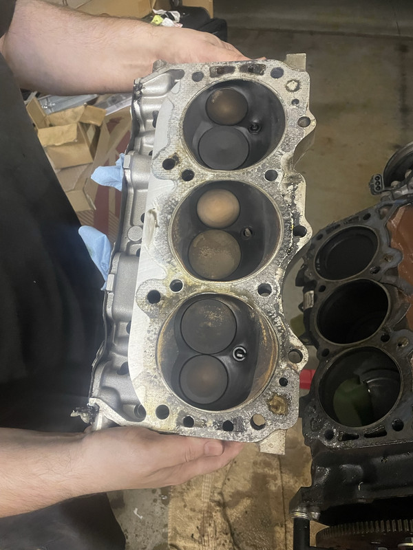

Update: CARNAGE!

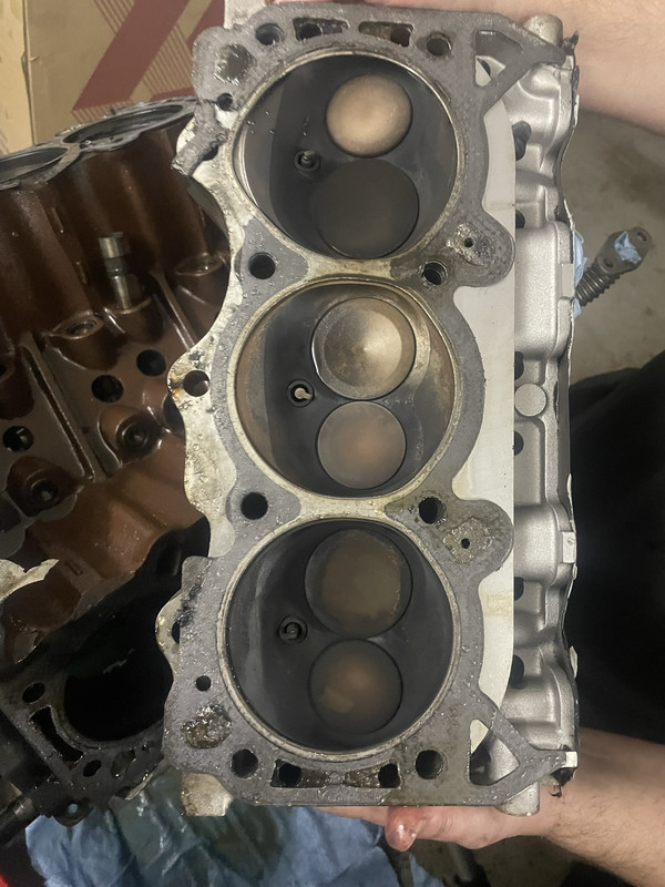

Pulled the motor out and disassembled, all thats left to pull is the crank & girdle & camshaft.

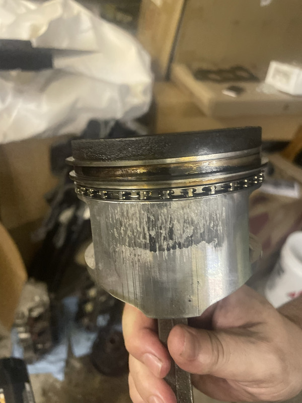

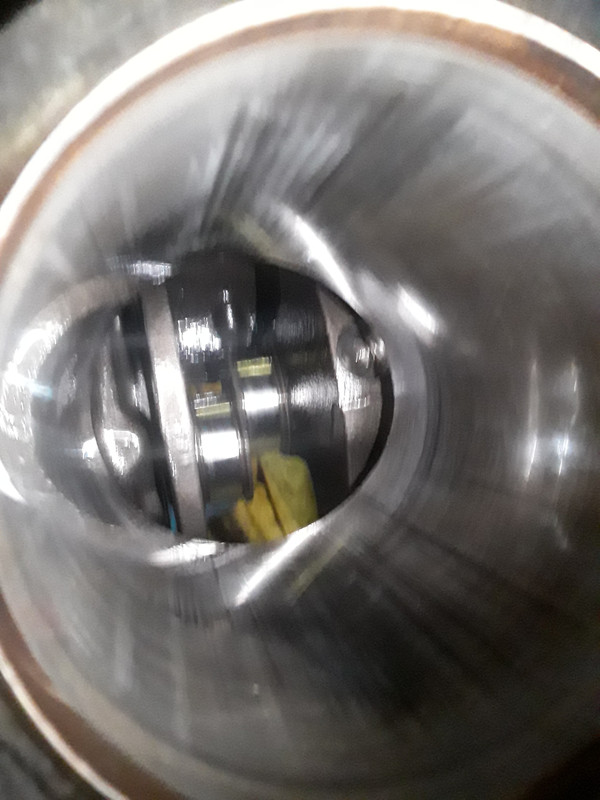

BOTH head gaskets were blown....ALL the JE "97m" pistons are fried no cracks but the walls look f'ed! All the pistons wrist pins seemed seized to the rod, they would freely move. The cylinders are ALL scorned some worse then others....but it gets better, I measured and that block + pistons they are already 40 over. Now its upto the machine shop to see how far they have to go in the hone to clean it up. Its time for either a new 109 block, or hone it smooth and go with custom pistons n rods.
All of this damage because of 1 rad hose that wasn't tightened and I lost all coolant over heating the motor on the freeway.
Pics to follow shortly. I'll have to verify the bore n piston size, my measuring tool is a cheapy from harbor. But pretty sure its 40 over...maybe go sleeves??
I'm reading 60 over will work but depends on the results of sonic checking the block
Food for thought. I had a .030 over block I raced. I cracked into the water jacket in 3 separate cylinders. I sleeved the first two, but the third went right up to the deck and I had to scrap the block. I highly suggest you find a block as close to standard as possible.
While you're at it, check to see how far the main and rod journals have been ground. It's been rebuilt at least once, so it's likely been ground. If the rods/crank can be salvaged, have both magnafluxed. And have the big ends on the rods checked for size. You're into a new set of pistons as well.

Wrist pins and pistons swelled up, shoved the pistons into the walls, created the mess.
Pay attention to the heads, too. Warped? Cracked? etc?

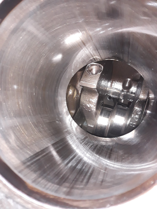

Here's the pics from the .030 over block I mentioned above:
Not all the pics but you get the idea...

I didn't see any cracks in the heads so thank god for that. I'm sure they warped a little and will have to be surfaced, when I get the surfacing done I'm going to do a valve job as well since I'm in it already. The crank is cast and looked to be 10 over. I just bought a forged crank so I have that ready to go and be balanced with new rods and new pistons. Hoping to find a block standard bore if possible, but I'll take a 10, 20, even 30 over block if its really nice and ready to rock.
