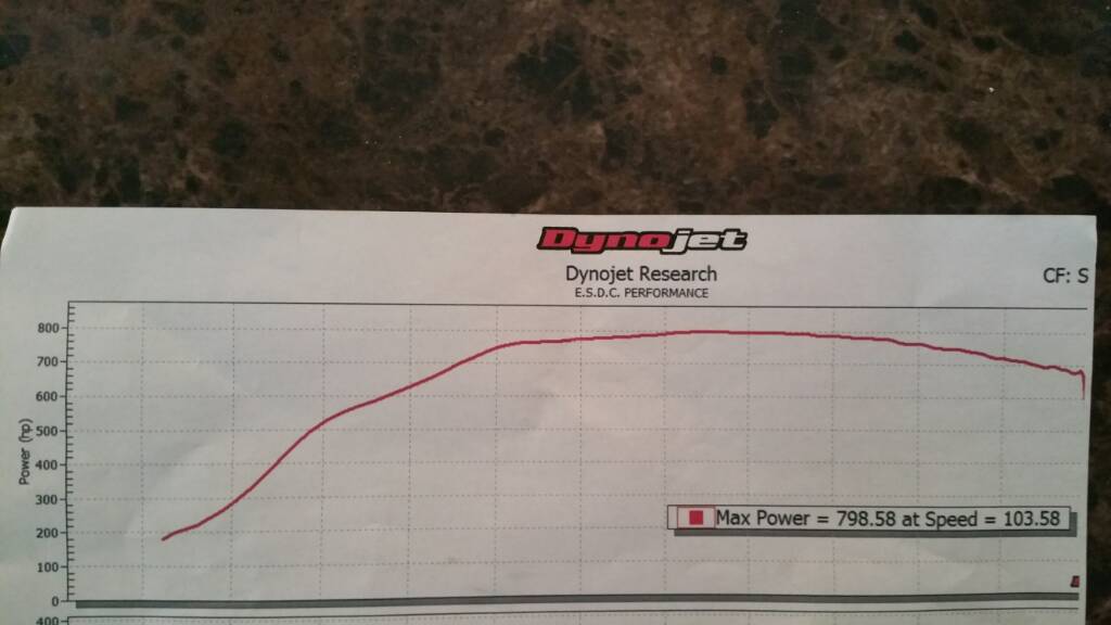

26 half psi to 27psi a few frames. I love this turbo
Should have been 27.5 for 800 lol
WOW Nat86, your car is making some crazy HP. Are you running a TA aluminum short block? How much cubic inch? At what rpm do you shift? Do you have any track times for your car?

Stroker ta engine ta heads 274 cubes. Last time out at track 22 psi 23psi a couple frames horrible 60-foot time and air quality was in the 4800 elevation 9.84 I just changed out my whole rear suspension .shifting at 6500.
