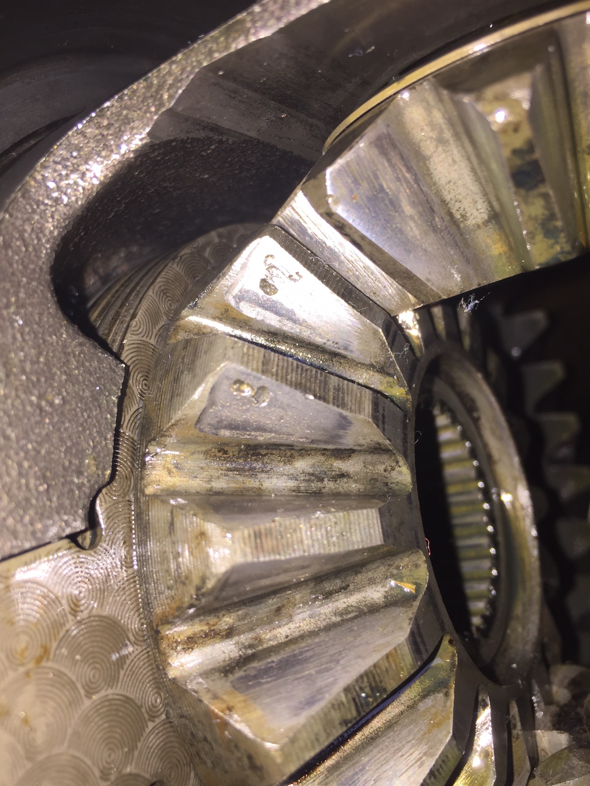

What a mess I have created. I must’ve scraped these teeth when I broke the s clip. Is this ok to run with or....
Na , car has some miles on it. If under the gear looks like the none wearing surface the clutches are in good shape. Car mostly stock?
It was mostly stock...before I took it all apart. It has less than 70k on it, half of those miles I put on. The clutches look almost exactly like the rest of the surface.
