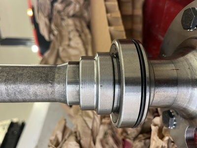

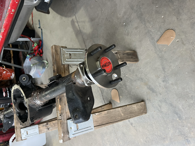

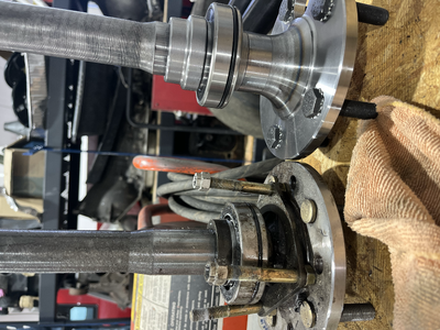

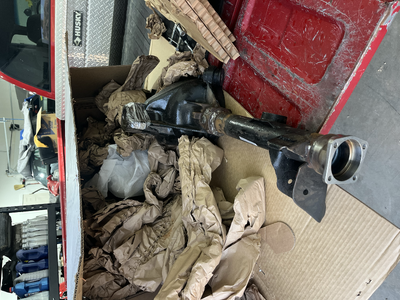

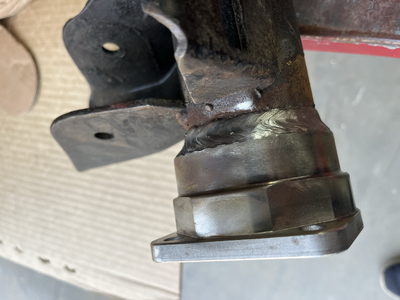

Look what the big brown truck dropped off
It was time to move forward. My C clip eliminator was ok but the 28 spline was at its max.
Ill be using 1980 Camaro brakes , same 9.5 drum as GN and 7/8 wheel cylinder. Need a adapter for the break lines.
I could have stayed 12mm but I went 1/2 in.
