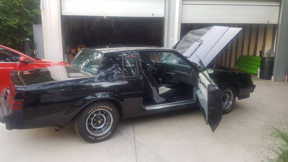

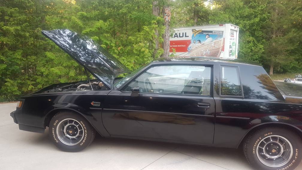

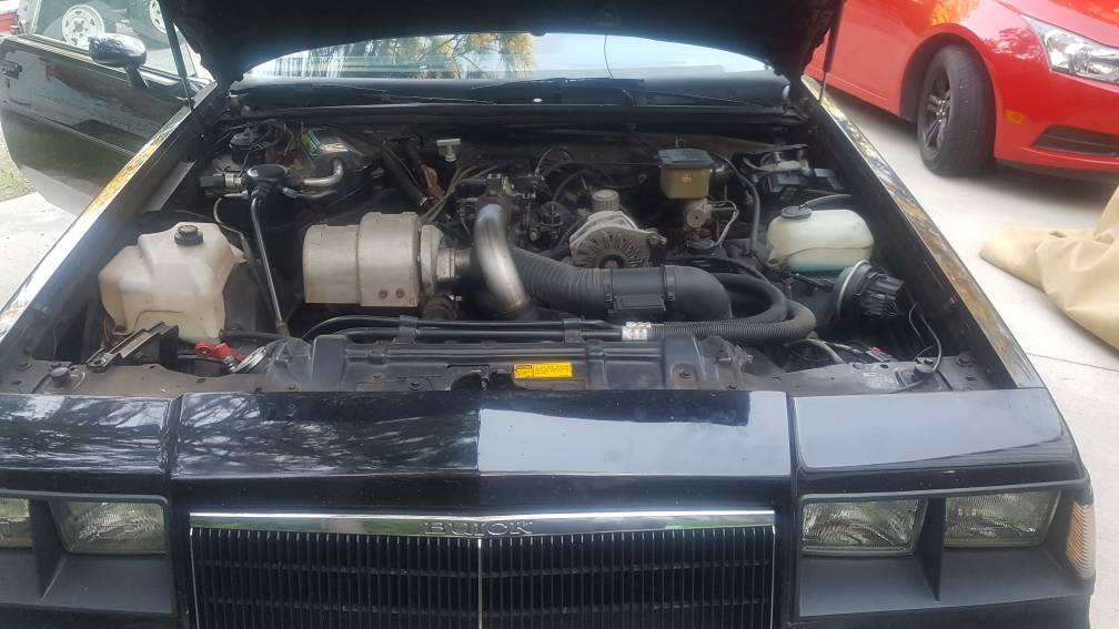

Awful pictures but she's home. Not gonna lie, been doing my research with great suggestions from everyone. Just gotta get the stones to do it and hope I don't mess it up. No idea how to get the injectors off. Also, any recommendations for a new fuel tank and pump. Don't know the first thing about hotwire kits. Easier the better.

Hello and Welcome to the site and Congrats on your car . Please post us up some pics so we can see what we working with .
Anything specific you'd like pictures of? I'm hoping to get started now that she's out here.

Only thing was replaced the exhaust, just changed up the pipes. Everything else is stock and regular maintenance. I have new plugs and new plug wires. I'm trying to follow the spring cleaning list. However touching the transmission worries me haha I'm going to clean the intercooler with O2 safe carb cleaner. Can I use kerosene to clean the fuel tank?

Keep it stock. Except, some items just will need upgrading, like fuel pump and the chip since todays gas you can't run as much timing as the stock chip has in it.
What is involved with changing a chip? Do you recommend a good tank and pump combo, I'm lost when it comes to hotwire kits.

Changing the chip is pretty easy the ecm is located passenger side kick panel.
There are many options you can do it all depends on what you want

That looks like a carbon copy of my GN when I got it 3 years ago. It wouldn't even do a burnout when I got it. Couldn't even turn one tire just a little. The first thing I did was the following, Hotwire kit from Racetronix, Adjustable fuel pressure regulator and a Chip/injector combo from Turbo Tweak. I also did MSD wires and NGK plugs. I also got rid of the factory air box set up and replaced with a nice K&N Filter. After those important mods the car would light the tires right up and make full power. It even ran a solid 13.80 on stock tires with no launch. That's where I would start. All of those things are really easy to do they just take a little time and maybe $500-800 bucks.

I ended up with delco plugs and ngk wires. It's all original. Found an oil leak and what looked like coolant in the air filter yesterday. I did haul it 4000km (I'm in Alberta Canada) so I guess fluids could have moved around. I dunno, today is clean the intercooler and air filter k&n. Hasn't run in 12 years so I'm gonna attack the tank and pump this weekend too. Gotta research hotwire kits. I know nothing about em.
