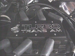

Jun 13, 2005 #1 O oreo New Member Joined Jan 19, 2004 Messages 2 What is the firing order for an 89 Turbo T/A? How is the Coil Pack numbered as you look at it from the front of the motor? What are the numbers for the 3 ignition wire posts in front of the Coil Pack and the 3 in the rear?

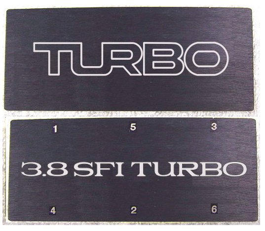

Jun 13, 2005 #3 8 89ICBM Member Joined Feb 23, 2004 Messages 486 Looking down on the coil pack, facing the rear of the car thru thru the windshield; coil pack 1 5 3 4 2 6 plugs 6 5 4 3 2 1 The coil pack is actually marked but it is hard to see.
