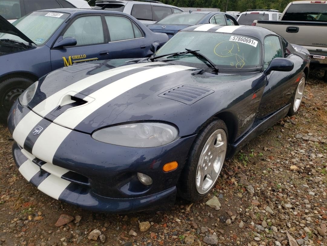

The newest addition has been sucking up most of the time lately.
