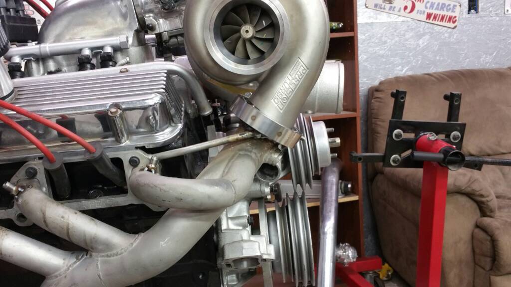

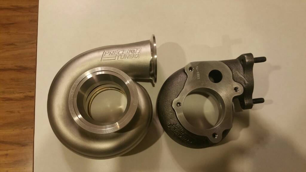

The outlet is 3 1/2 inlet I will go out and measure it I know it was bigger than the opening on the header I had a gap around the V band that I welded on to the header

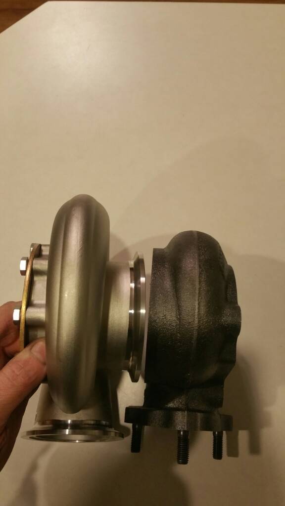

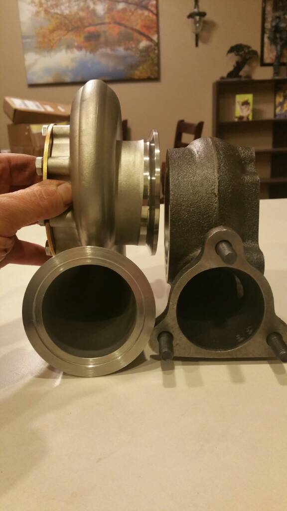

Can you take a side by side with both housings centered to see if the flange extends further down?
I would my friend but I already sold the 3 bolt housing this is the closest picture of comparison I'm going out to my shop to measure the inlet like you asked I will report back

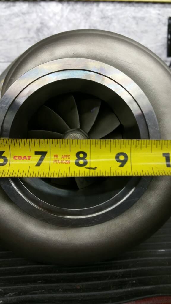

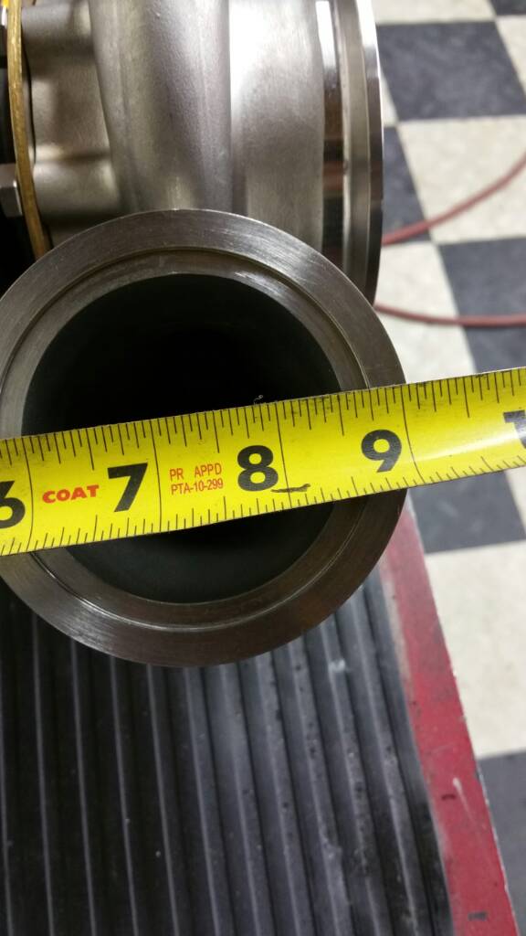

What size is the v-band on the inlet and outlet?
Inlet and outlet. And a side shot of my dirty ass exhaust headers can't wait to get all this stuff TIG welded and then powder coated but I have to wait till the TA engines in so I can mock up my wastegate pipe off of the header just waiting waiting waiting for the engine
