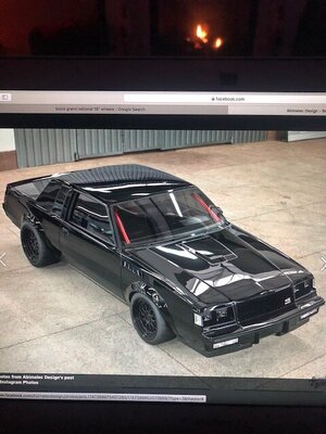

I know this is a long shot on such an old thread, but did anyone get 10" wide wheels on the front or something in the area of 285 front and 295-305 wide rears? Have pics? Backspacing/spacers, etc...? I'm looking at xxr521 wheels with GNX flares for the GNX look, but slightly more muscular. I'd like the tires to be almost even with the fender flares, if possible. Like this picture:
If you want the wheels flush with the flares you’ll have to cut the fenders out like the GNX and trim the flairs.
The aftermarket flares are just for looks and don’t provide additional space for the tire.
Here’s how the GNX fenders were cut. You may have to go more extreme if you want to lower your car.
Your setup will be different than most so you’ll have to make the fender mods and do some measuring.
