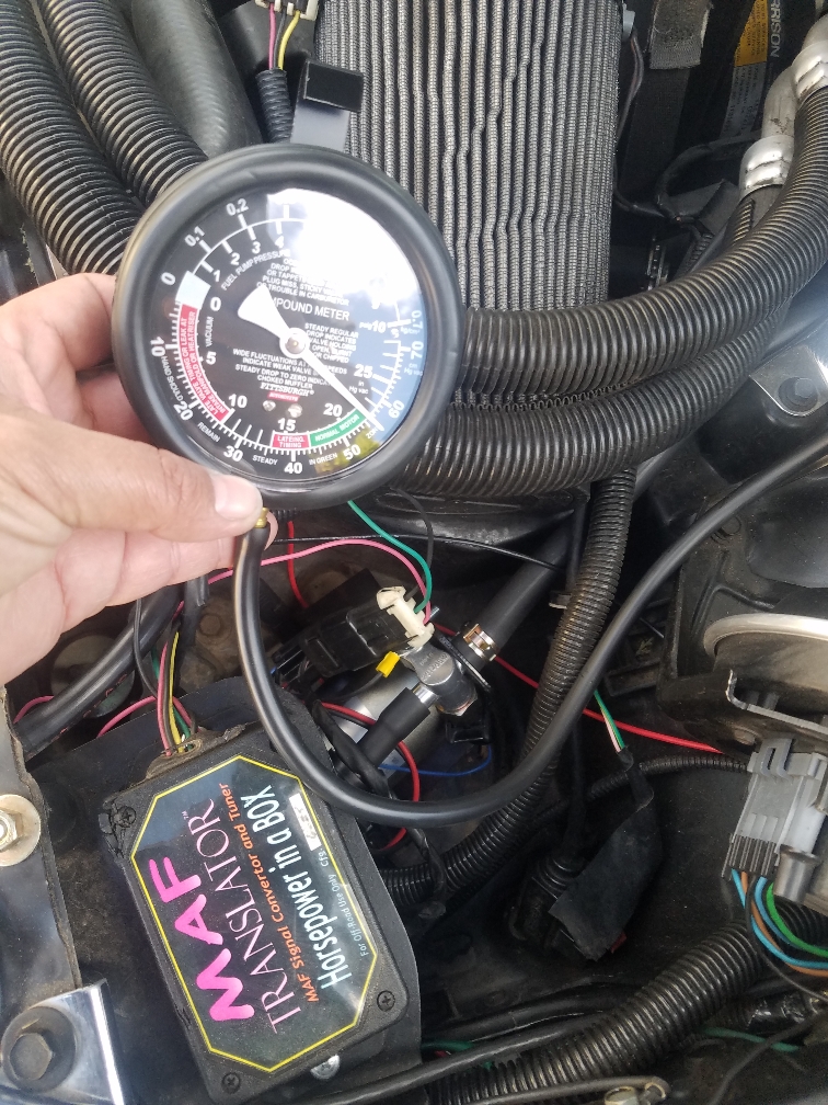

First picture is with the bandit holding an shut off.22hg

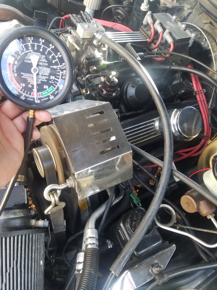

2nd picture is off the plenum....not good Vac.15hg you need a minimum of 17to work a booster.

I'd say the booster is junk.
vacuum brake boosters can go bad and leak due to rust or gasoline exposure , hearing a hiss inside car id say replace the booster thats mounted on the firewall
17in/hg of vac should be fine , you dont need a supplemental vac source unless you have less than 12 in/hg of vac
you need to make surethe check that presses into the vac booster holds , if check valve works but the vac leaks down then the booster is bad
