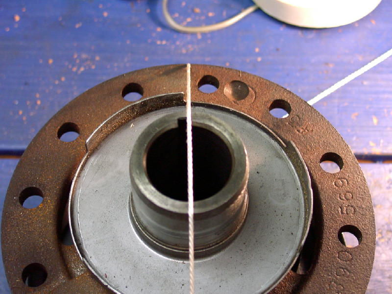

When pressing the reluctor to the harmonic balancer it should look something like this
