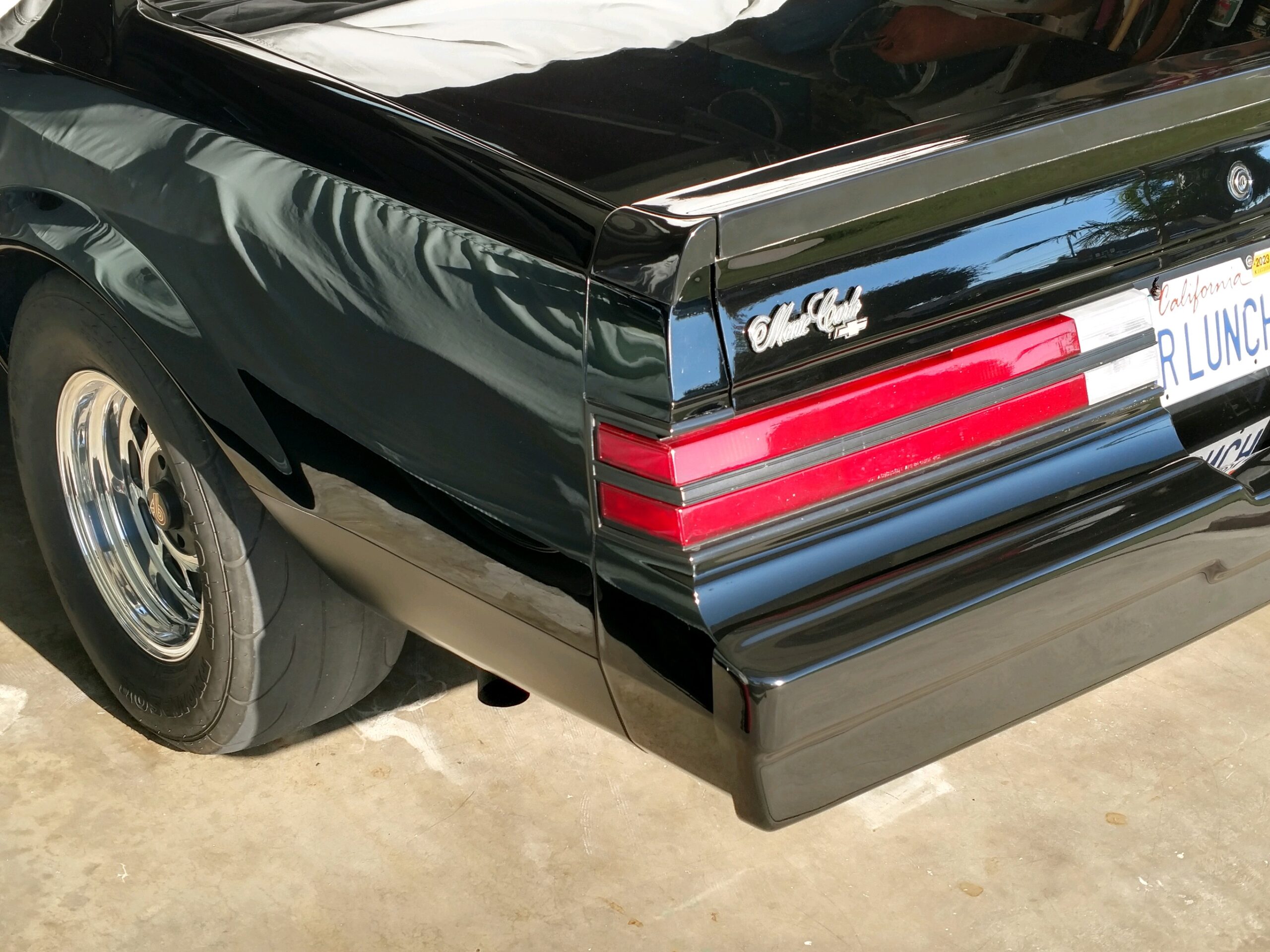

I have the SpoolFool bumpers and they look great! Also they shave quite a bit of weight off too if you have the steel bumpers. And if you have the aluminum bumper supports you can recoup some of your money.
