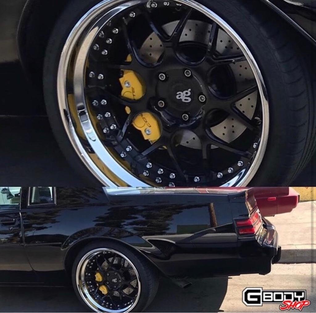

Or you can do front blazer 2wd drive spindles with blazer hub, front c6 14” rotors and 6 piston calipers and 4 piston rear 13” rotor Kore 3 brake hoses and brackets with vacuum or hydroboost, maybe even manual brake system. Lowered mine with aldan american coilovers.

Is there a kit for those rear brakes?

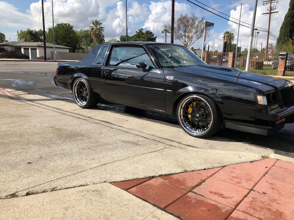

I’ll have a ridetech street grip suspension set up for sale soon. I installed it last winter and only put maybe 500 miles on it. Was a good set up but to low for my liking. It lowered the car 2” all the way around. Here is a picture with ridetech street grip installed. I paid $2500 shipped to my door. If someone is interested I’ll sell for $1000 plus shipping.
