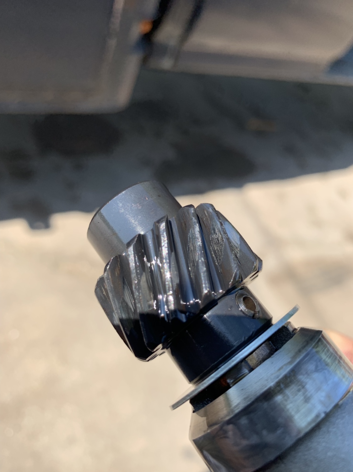

Okay so I pulled my distributor out to replace it with the new one and looks like the teeth on the distributor are worn pretty good I think this verifies some of my high oil pressure suspicions what color spring should I run I still have an assortments t
hat came with the oil pump rebuild kit
That distributor gear wear looks normal. When they are completly knife edged or the middle is worn out its time for replacement.
That distributor was new 4 weeks ago it has some pretty big grooves cut into it looks worse then the distributor that cane out of my small block Chevy after 7 years of service. I went a head and replaced it and swapped my white spring in my oil pump for the yellow spring that I believe will lower my oil pressure and maybe fix a couple oil leaks on this engine I didn’t get a chance to throw a pressure gauge on but I am pretty sure my oil pressure was pretty excessive it had lots of oil in the valve covers just at idle and I was getting oil into my pcv valve which was causing it to burn a little oil.
