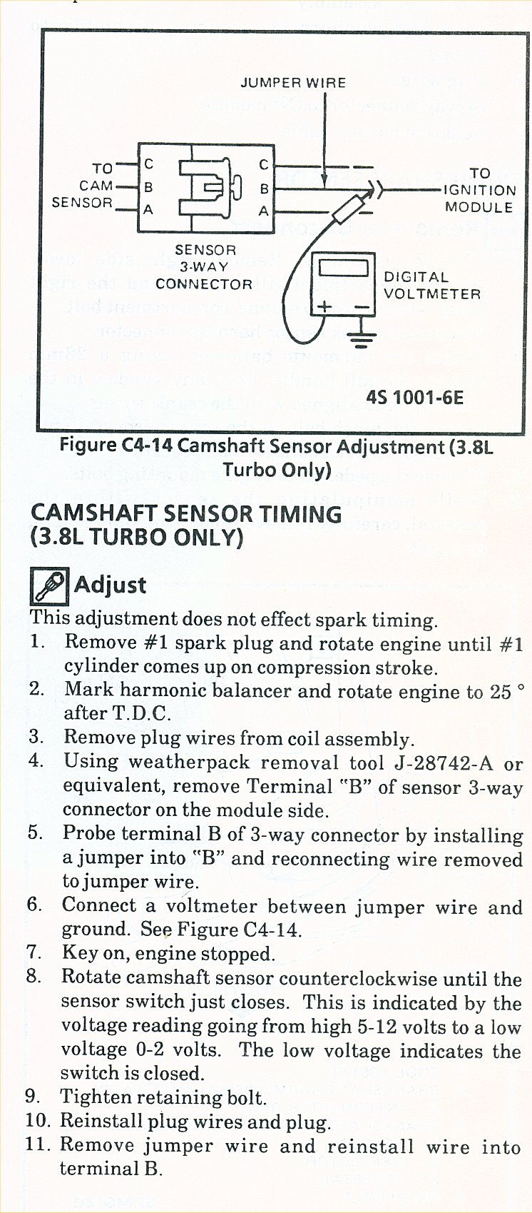

ok so here i am again. pulled the timing chain cover off and replaced the timing chain. i turned it over a couple times by hand to get to TDC. So my question is what do I have to do to get the cam position sensor set? I pulled the whole sensor out of the cover and put it back exactly where it came out.
Since I moved the camshaft itself around wont I have to reset the CPS anyway though? I dont wanna mess anything up so please give me some input!!!
Thanks
I just installed my cam sensor last night. It is real easy as long as you have a VOM. Ignore the "jumper wire" part. All you need is a meter probe with a sharp tip to pierce the wire insulation. The hard part for me was getting the sensor hold down bolt installed. I had to remove the "S" water hose to make clearance.
ok well that looks pretty simple. thank you.
