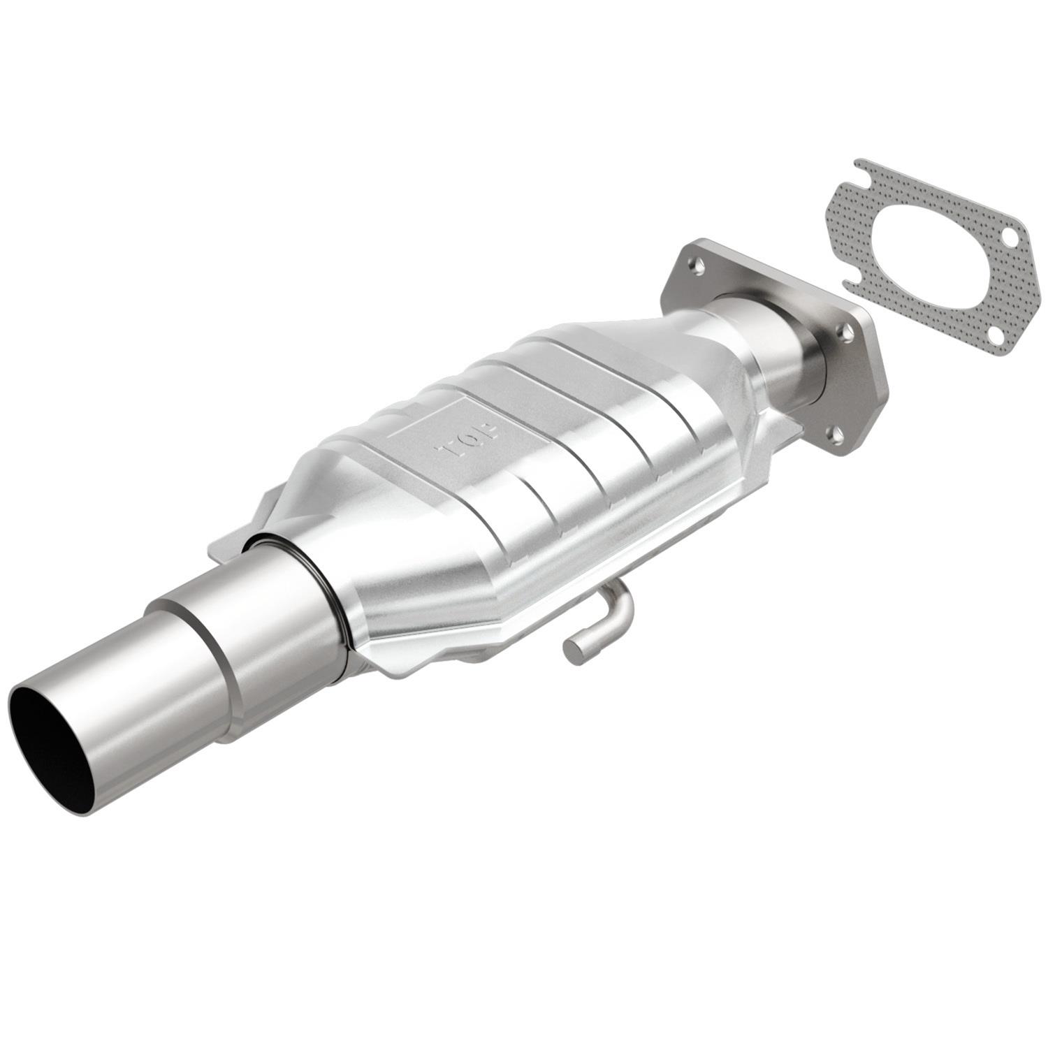

Unfortunately, "Not for sale in California, Colorado or New York" and no CA "EO" is available. CA is impossible to deal with , for a car enthusiast.
I can't find any Calif CARB-approved converters at magnaflow.

To clarify, no "direct fit" and Calif CARB compliant., but seems various "universal fit" converters are available. I'm just starting to dig into the cat converter issues in CA. Dont know what will pass both the tailpipe test and satisfy the fascist state bureaucracy

Sounds like you need to move.
In all seriousness, you're gonna need to get a universal fit with an EO and cut up the car. Sorry.

If they recognize the part's been replaced, which will be obvious, they can demand to see the CARB documentation for the replacement part. No documentation, automatic fail. I think there's even a sticker that comes with the CARB compliant ones you need to stick on the cowl.
Unless he can find a good genuine original cat, he's going to have to buy a compliant cat and make it fit.

Is it possible to acquire a carb worthy cat and have a flange welded on?

RJC Racing sells the flange, I got mine in 3" but it says he has the stock flange size as well.

Call Magnaflow and see if they can supply the number i gave you. Ask for John, he know's his stuff. There are other options that are carb compliant. Have it set up with flanges before install and then you can swap it in and out of the car for "testing".
