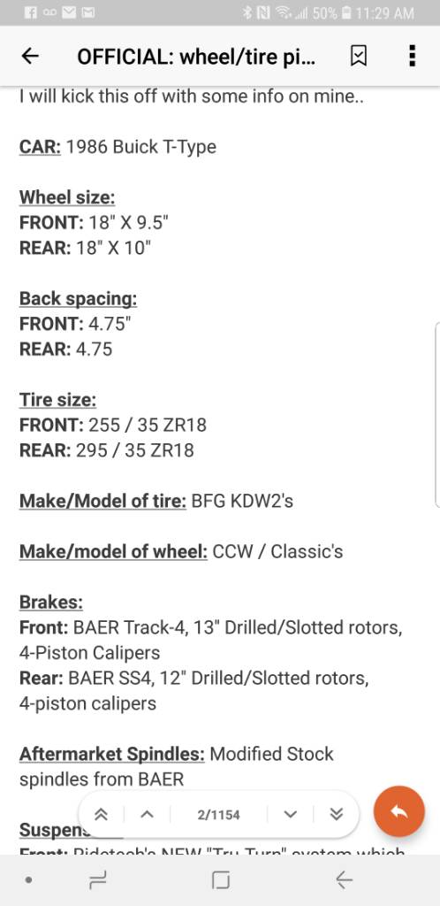

Going that big, you should measure the car and then give the measurements to CCW and they'll be able to set them up right. These wheels aren't something you can return if you get the backspace wrong and they don't fit, so you have to get it right the first time.

Remember I didn't end up going with the CCW wheels. the ones I did buy were 2600 just for the wheels. CCW would have been 4k just for the wheels. There is a sticky in this section of the forum where Scott from GNS talks about the offset of the wheels. I believe the offset for front and back was -23 but don't remember exactly.
These are the measurements I used

And just to confirm. The front wheels did end up at 4.50 do to me giving gmr wheels the wrong offset. They had never done a wheel for a grand national before so it was a little bit if trial and error. But they should have the specs on file after doing my wheels.

I just gave them my specs. But if you're close to them I'd stop by and have them take measurements.
