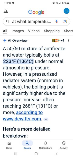

Great information. This clip explains the science.
