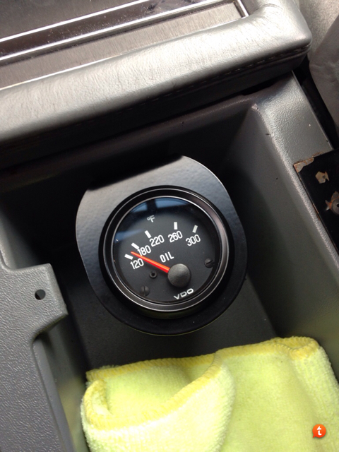

After a 60 miles cruise and in stop and go traffic in 75 degree weather Trans temps never went above 160.
Really, really happy!
