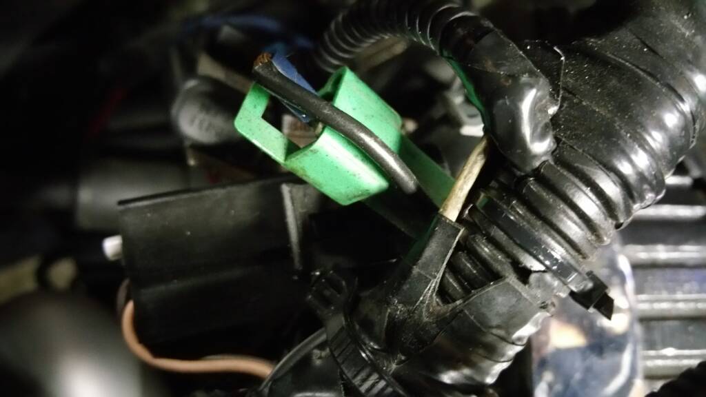

Ok, I just ran the green wire from behind the alternator to the tach screw on the dakota brain and nadda...Someone told me there is something else I have to put inbetween that wire? Anyone know exactly what part it is again?

Yeah I just did it..Put it on v6 and low 5 volts and nothing..Even tried 12 volts and still nadda..Someone had mentioned to me that there is another piece that may be needed..Ever hear of that? Something else inline between that green plug and the TACH connection on the dakota brain
Call up Dakota I'm sure that they have heard of this before
