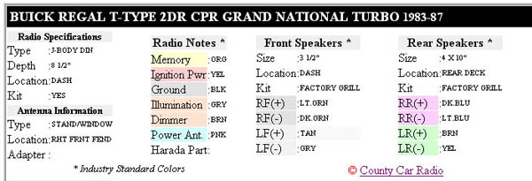

i have an 87 turbo t that used to have an aftermarket cd player that no longer works. the wires from under the dash were cut to fit the wiring on the cd player. i have a Delco cassette w/eq out of a 91 lasabre that came with the 3 harnesses for speakers front, rear and the other for basic controls i guess. my question is does anyone know what wires are what under the dash ex: red=hot black=ground. so as i dont mess anything up. thanks please help.
