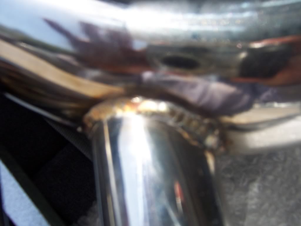

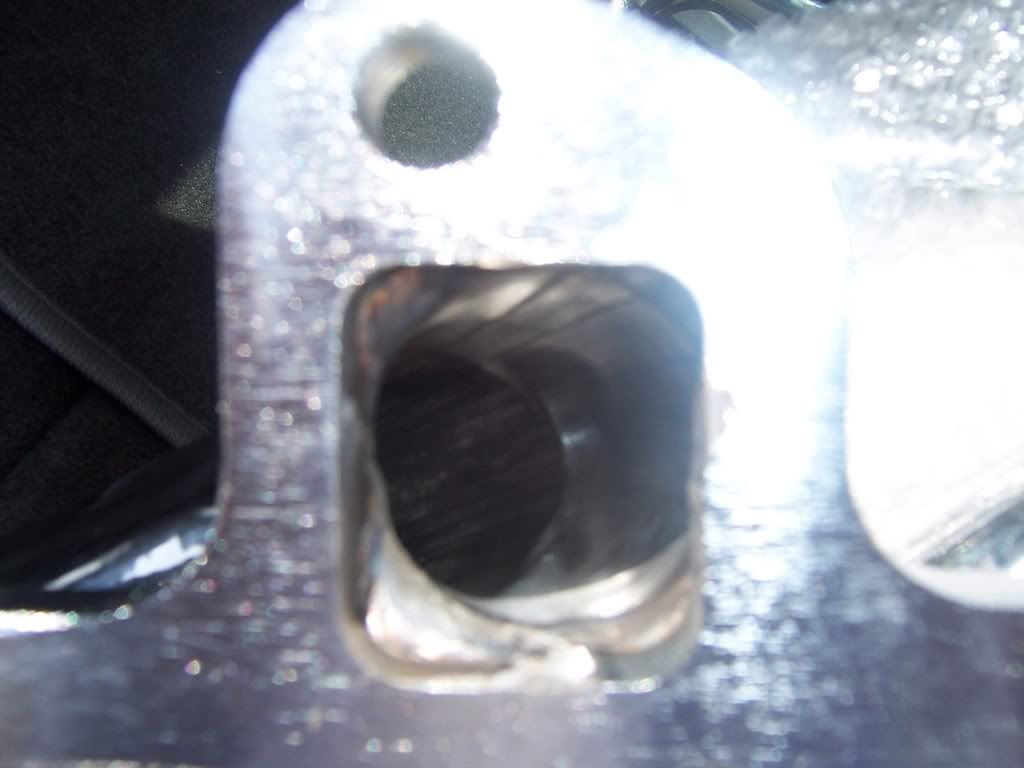

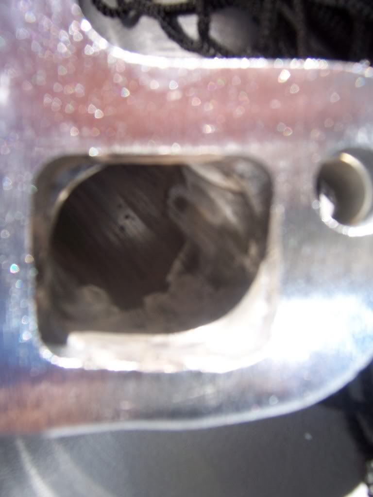

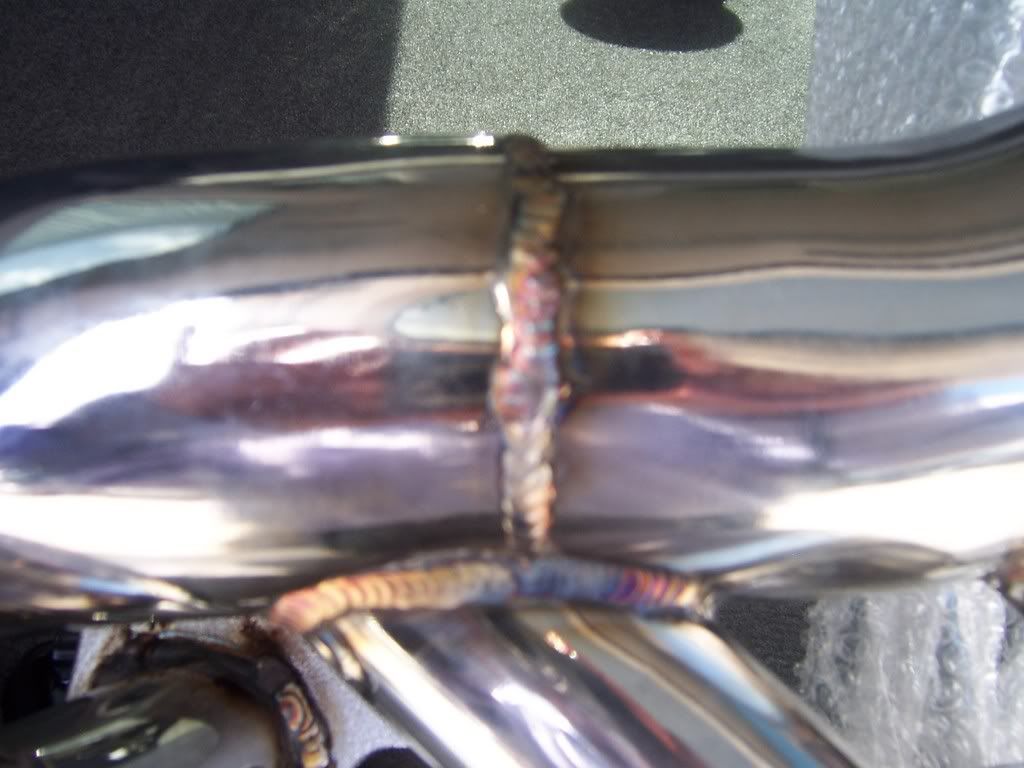

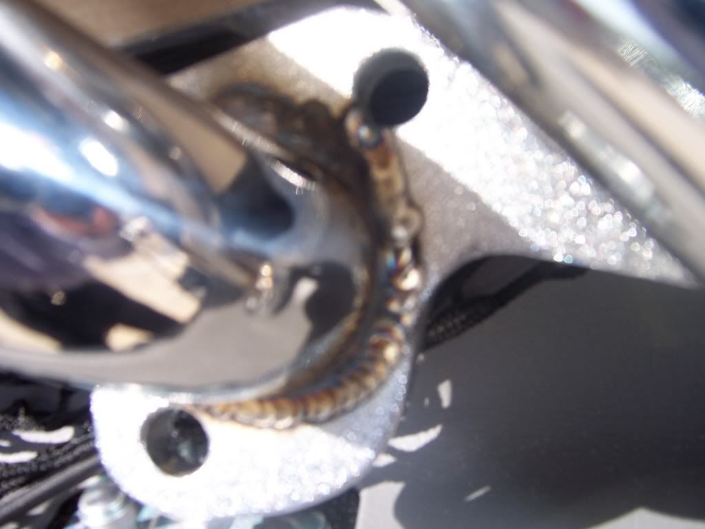

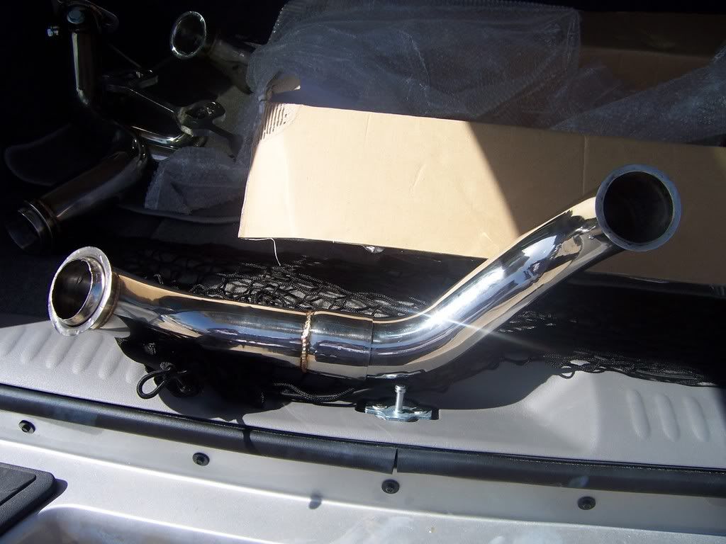

Guys,

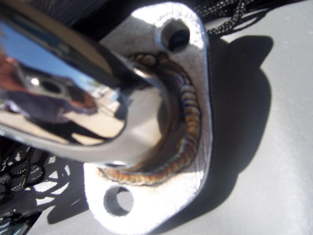

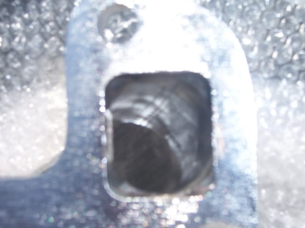

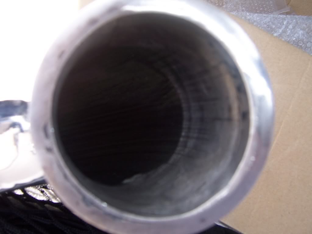

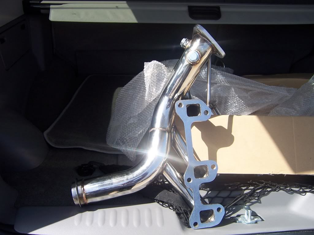

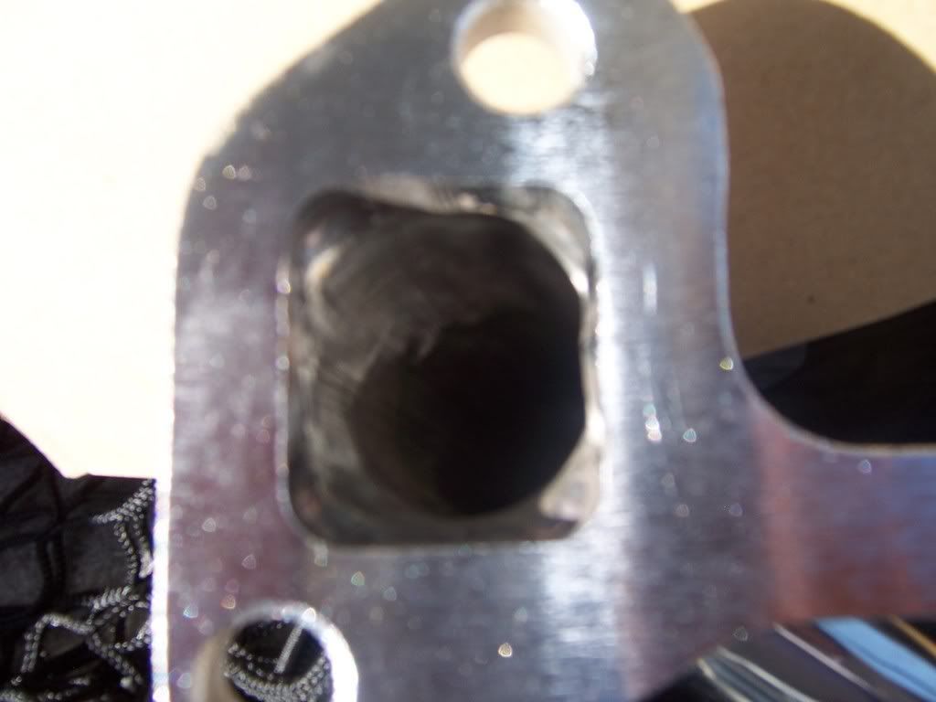

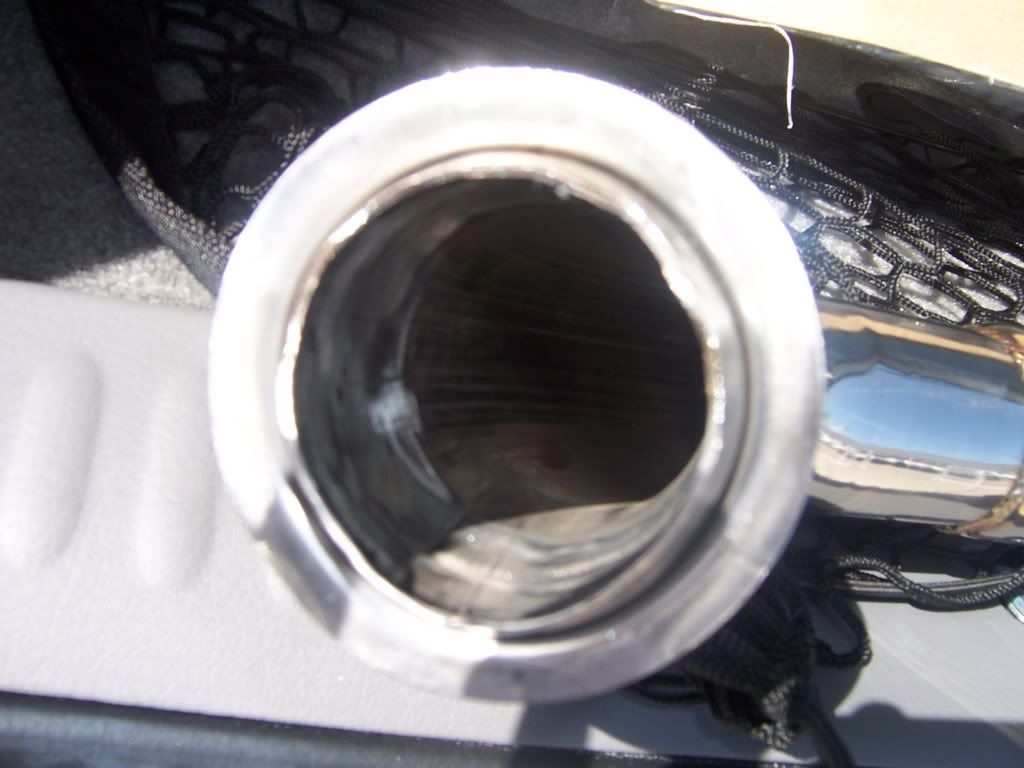

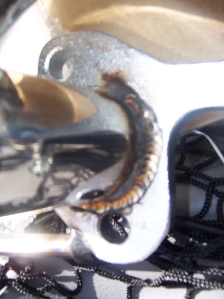

I hope I don't get thrashed for this, but I thought it would be nice for you guys who are interesed in these look at pictures of the welding quality and craftman ship of these headers! I am very impressed with the external welding of these headers... I know that some people have posted some pictures of the actual flange and ports, but I don't think I saw any pictures of the internal parts of the pipes..... (Where the pipes get welded to the main pipe connected to 3 bolt flange for turbo. Thought you guys might like these photos. I am not to happy with the size of the ports!
Thanks,
Sam

If you look at the last 2 pictures... Sorry they are not very clear.... The beads you see in the interior is the actual size of the pipe as it's welded to the main pipe..... Look at how small the holes are in relation to the actual size of the pipe. Seems more like a restriction on the passenger side header!
It definitely would seem like that would be a huge restriction - that needs opened up to the size of the tubing. It looks like something similar is going on with the collector in the third pic but it might be the angle.
Jim
That last picture was just plain BAD! Shouldn't be surprising though, just another set of chinese knock offs.
More pictures.... I was thinking of just cutting a piece of the opposite side of the welds and porting it out... I would still have an extra $845 dollars in my pocket rather than spending 1045 dollars for the stainless ta headers

I am happy!!!! I know what to do to correct it.
For example! if the flanges need to be planed out correctly... its about a $50 dollar fix!(at the machine shop) if the cuts that i am going to make to open the ports up need to be made and welded, it's another $30 bucks... so I've got a set of stainless steel headers that have a total cost of $330 rather than $1025 plus shipping from in comparison to new TA headers!
okay so. 1025 for the headers + 20 for shipping = 1045 - 330 = $715 (that's almost a new turbo) I don't know about you guys, but $715 dollars is still a ton of money to be saved!
