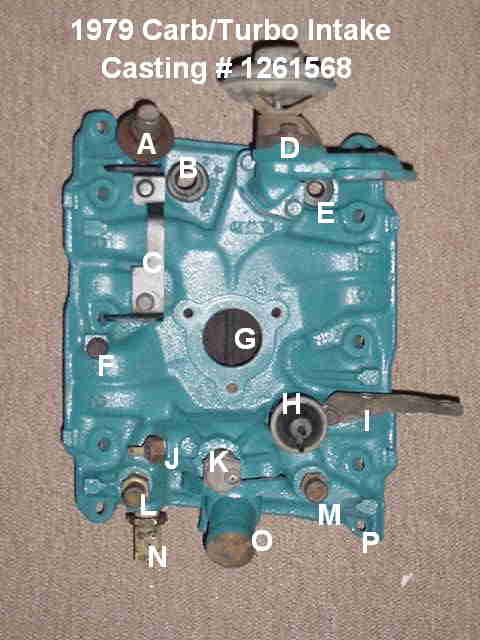

Right now the engine still has the old plenum. I got lost when you spoke of the plenum and lower intake. I kept thinking on that and went to the manual and instantly saw what you must have meant. This plenum that I have been working on (from a swap meet and assume its from 83 maybe 84?) has a tunnel out the back that the EGR bolts to. It uses the fel-pro 70978 gasket. That's the same gasket the 79-84 use.
The stock plenum on the car right now is heated with water, or was until I caped it and removed the hoses. I couldn't see behind the carb and didn't notice the EGR going into the manifold. If I had gone to your web site I could have seen where it does. The tunnel between the plenum and manifold is where the EGR goes. On this new plenum the tunnel is molded to it with the EGR bolting directly behind. It (new plenum) also has water going to it but I was going to block that to.

Oh, you need to block the EGR off at the lower intake where that little manifold was. At the two bolts just below and to the left of the letter D.
And if you getting rid of the smog pump, you might want to replace the check valve A with a pipe plug.
Yea, I've already taken the pump off and blocked A. The EGR is my concern. I have the gasket and plate to block the new plenum but not the manifold place under D. I think, or hope, its the same gasket and plate. I had to find the pate that could be used with the EGR gasket off the back of the plenum. In this case it was for the AMC AMX JEEP EAGLE GM OLDS on ebay. I guess I'll order another for the manifold location. It looks the same. Do you know?
It's not the same. It only has one hole. Looks more this this:
You may have to make it yourself.
