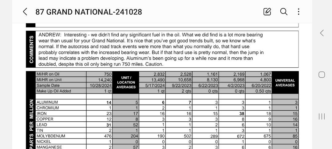

I got this oil report back after my last event of the season. Lead, copper and all the other metals spiked noticeably:

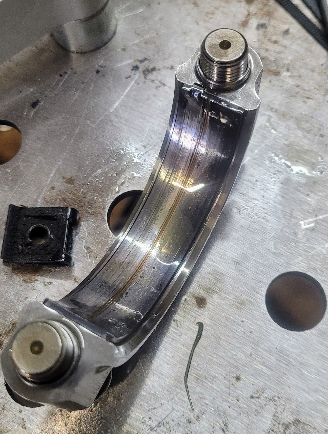

Now, there was no noise from the engine. Oil pressure was great, 80 psi+ on startup, 30 at idle warmed up. But that huge spike is a big red flag, so I dropped the pan and pulled a rod cap:
AP1GczOlMX1Q5lxITrcFw-4F4YJXSnPyL9If8rfWqArEQADZ5WhblyHX9uZGyL74O5c44IZ4_ZqGYUF9ju6sgR0jmF421ZNYDoheyxE8P1Ce77YHes89sLIo=w1080

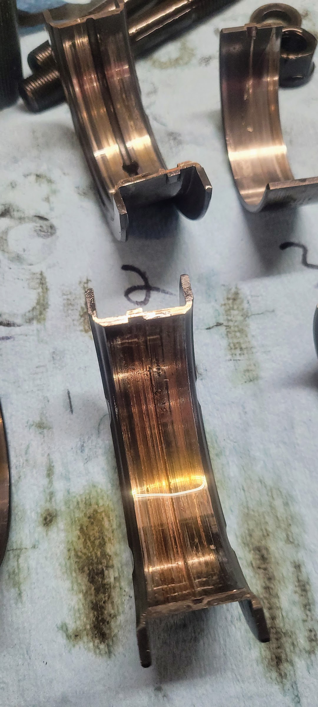

So I pulled the number 2 main cap:
AP1GczNviJsaObbBA-jPv9mI02x8gTlhBvZnLTPFx3QFiU2X7Ff7r1VLvhLCyn6z718gl_NAbAaKQroDc8vNCagrLaHHvbvW9IRNyCKvShW9BFMQ5PUToxoV=w1080
Yeah, WTF?

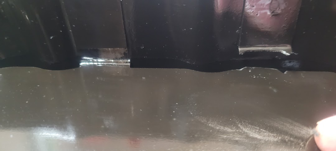

Well, I went ahead and pulled it. First thing I noticed was the windage baffle was broken away from the oil pan on the passenger side:
AP1GczPlva4mbswXMIKzTenmabr36Bum7wqeW4V00IgtNjup30qqZH9q-hS-Wmm5u_aomhvcgELNljpp7AJkyp6RWyioiu4gDgKyS1gs1XXI6QJAi0EfVVrN=w1080
Concerning, but there were no chunks missing from the fractured areas. So maybe? But let's keep looking.

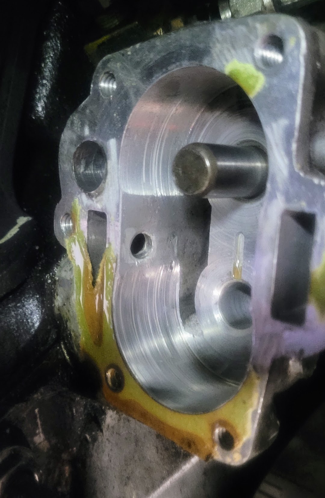

The oil pump took a beating:
AP1GczPfaTSkdUQeEgiVOh3enU9a5rHv_k1UgFcispiC7_mnVCC-97FlR4s2ThbGWemczCVGbLEOv0H9lrsI1CQ6eybfmcQ3nC9LKrDFlgx1w2-cUngsBg7Q=w1080

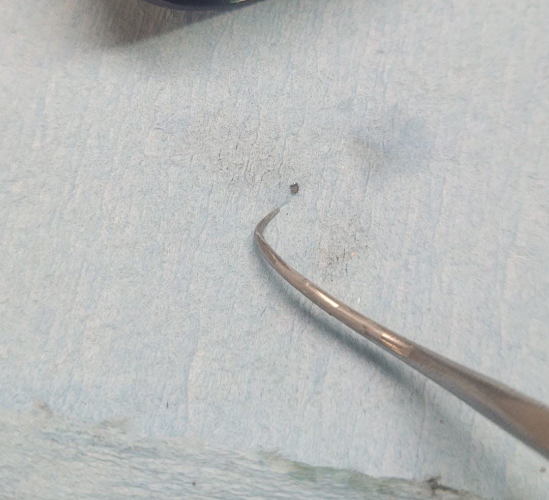

I found just a tiny piece of metal in the turbo filter, I think this is a symptom not a cause:

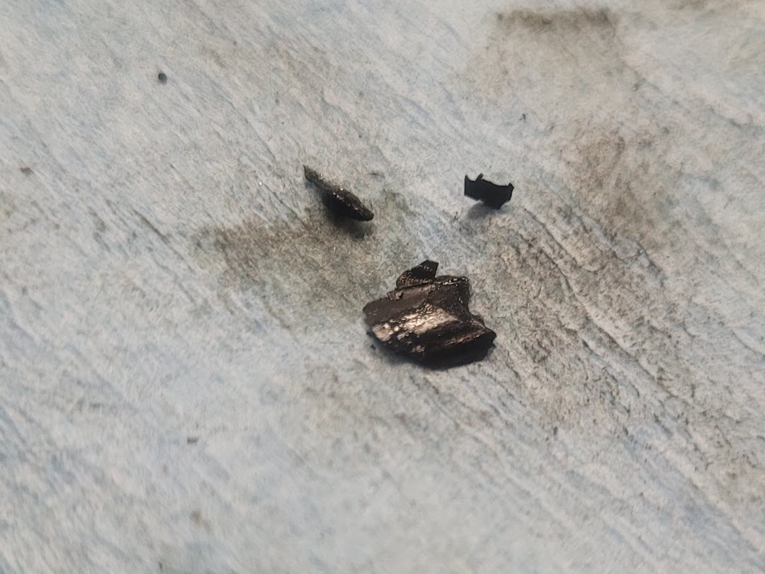

And I found several of these little chunks of something non-metallic (checked with a meter), but really hard stuck in the mesh of the oil pickup:

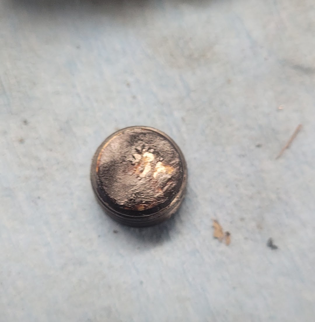

Pulling the oil galley plugs, and I find this:
AP1GczNpCowGS5iM-B-5YZhOZKyvfOpdQT6buUdcZG583lmqGMSgIx6irsnaQgKRRvUxYSjGJFl6ND0Xpcv8-oIPm8iCMNt9cbTetl2ZE2iaZ9jM7KAl5Ubn=w1080
So, the best hypothesis I have is there was way too much loctite used on these galley plugs and some chunks broke off and went through the pump and out to the mains and trashed the bearings. The debris from the bearings went through and scored the cam bearings slightly, just streaks in the teflon. But the hard parts are unharmed. The crank is beautiful, the camshaft looks perfect. A $35 lab report saved this engine. Without it it would have run just fine while those bearings continued to disintegrate and eventually something big happened.

The block was fully deburred the last time It went to the machine shop, and it wasn't shot braded or media blasted. Very little of the debris I've found would stick to a magnet. Nothing in the piston skirts, no scuffing on the piston walls. If you look at the iron in the oil report it's elevated, but by only by 30% over the previous sample. Lead went up 3400%, copper went up 400%, and aluminum went up 133%. But chromium didn't move, so the problem didn't make it to the rings. I don't think this issue came from the block itself. I'd expect to see more iron in the sample and the debris would stick to a magnet. Given no damage to the crank, I think most of that iron came from the oil pump gears. They were pretty rough.

The moly increase is the oil I used. The previous sample was regular synthetic, but I fill it with Motul 300V for track events. If you look at the past samples, you'll see increased moly, those fills were all 300V and those moly counts are consistent with the additive package in that product.
