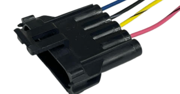

In a related issue, I have a, what I believe to be, functioning ESC. However, the wires going into the harness connector that plug into the ESC are bent, fatigued, and the insulation is deteriorating. Which of course only leads to corrosion and future issues. Does anyone know the part # of the GM metripack female connectors that seat into this connector are?That the male pin ends of the ESC integrate into? I already had to do this with the CCCI connector and it was a stroke of luck I found those so easy. NAPA has a pretty good selection on hand, but I need a part # to bring them.
Thanks for the replies, gentleman. I think I am gonna just order both the tail and some ends. Can never have too much of that stuff around.
