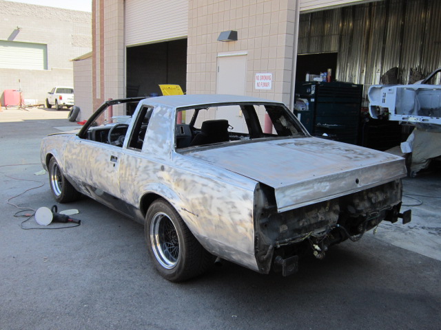

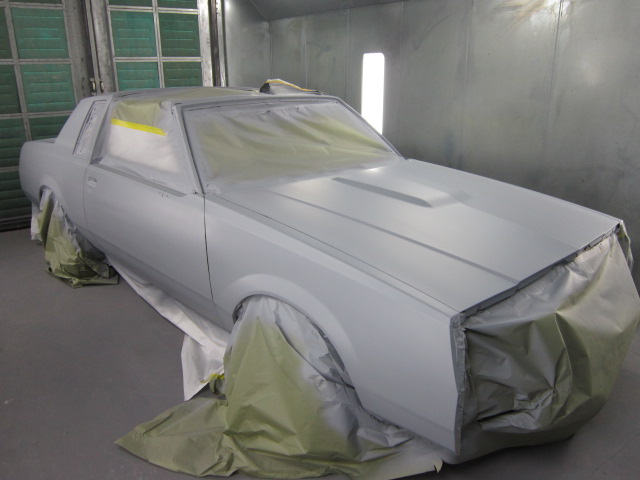

I spent the spring taking the car apart in preperation for paint and body work. I had some rot in the T Top areas. I had the same guy who filled my fender fix all that and shave my bumpers. I don't have any pics of the work. I totally forgot to take any. I finally got it to Heath Elmer's shop to do all the stuff that is over my head. Once the car is painted, I will reassemble everything.
Here is the car stripped down:
Here is the car in primer:
