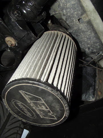

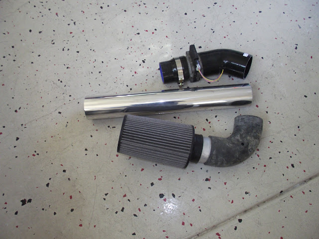

I got a MAF translator Gen II and needed to make a cold air intake for my LS1 MAF, so I rummaged around the garage to see what I had. I already had a 3.5" 90 degree elbow and a 3.5" AEM filter. I bought some polished aluminum 3.5" tubing and a 45 degree silicone bend for about $50.
I put the IAT in the bend, cut the pipe to fit, shortened part of the 45, shortened my 3" intake, and voila!

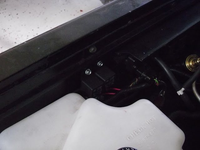

The other project I did was setup a couple relays that are activated off of a Hobbs switch. The switch activates the relays at 10psi.
One relay was intended to activate a home made volt booster found here:
http://www.gnttype.org/techarea/projects/gnalt.html
According to my volt meter the signal wire is doing what it is supposed to, but it blew my fuse from my supply wire when I actually hooked it up to the alternator. I need to revisit that.

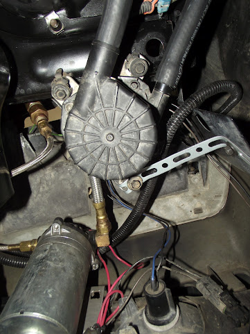

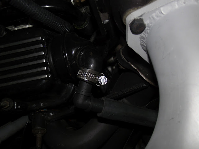

The other relay turns on a LS1 vacuum pump. Jason at RJC came up with the idea of plumbing it this way.

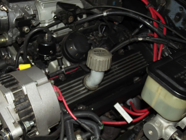

First, I put the stock oil filler neck on the DS valve cover so the motor is sealed.
Next, I put on the stock air / oil separator back on the PS valve cover.

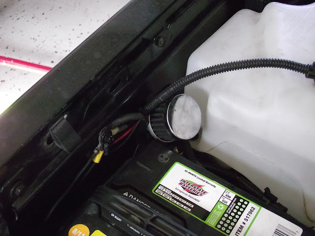

I run a hose from the PS valve cover to the inlet of the pump.
The pump is mounted under the car, just in front of the battery.
I ran the outlet of the pump to a breather. Jason recommended that I put an oil catch can after the pump, but I simply cannot find a spot to mount the one I have. So far there seems to be no need for it. The baffle in the valve cover and stock air / oil separator seem to be working good. This will hopefully pull enough crankcase pressure at WOT to keep the seals from leaking bad.
