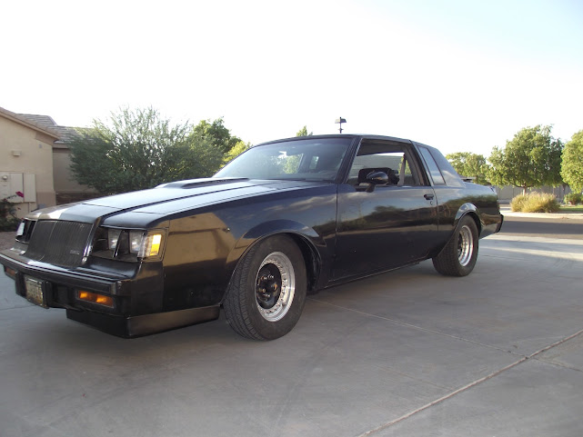

I got my car through emissions no problem!!! So now its back on the road. I am absolutely loving how this thing drives. I can't wait to get some miles on the motor and get it fine tuned. In a couple weeks I should have everything I need to start working on the interior. I will post up once I get to that point. In the mean time, I got a good deal on some new wheels / tires for the GN. I put on some GTA rims. The fronts are fronts and the rears are fronts that were widened to 8.5". The fronts have 245/50/16's and the rears have 255/50/16's. I also have a set of 275/55/16 M&H DR's that I will be mounting on a spare set of GTA fronts.
Here is my GN with the convo pros:

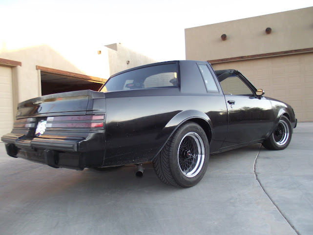

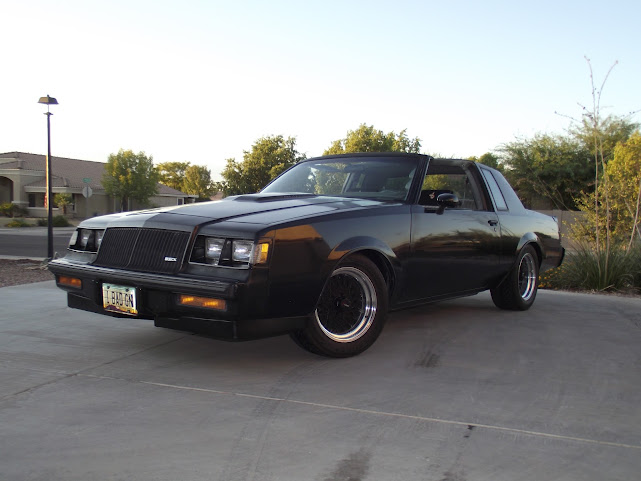

Here are the new wheels. I'd like to see some opinions on the new look.
The convos are not as common as the GTA's, but I'm sick of having skinnies in the front for regular driving. I will keep them around for possible track rims.
looks sweet with the the GTA wheels.mike you really did a nice job on youre ride!
Watch for rubbing on the rears. I put my M&H's on and drove it a few miles. No sounds of rubbing but when I took them off I saw a LITTLE bit of frame rub. Switched to alum drums and was good. My $.02 :)

I have aluminum drums so maybe I'll be ok. The fronts rub at full lock, but barely. I need to take care of that, but it's not critical right now.
