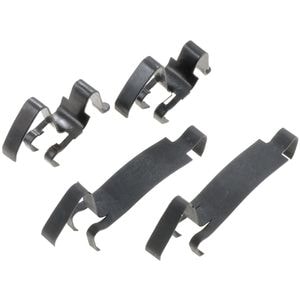

So there are these little add-on bits called anti rattle clips. Some pad manufacturers include them in pad sets, some don't. Some calipers have facilities for them to be installed, and some don't. I cannot recall if my GN has them, but I see them on nearly every other kind of car every day.
Dorman Brake Disc Pad Clip 26210
Dorman Brake Disc Pad Clip 26210​

cinch the ears on the outboard pad , books back in day said to use large channel lock pliers to cinch them but i stand the pad on a hard surface and tap the outer tab down with a hammer to get them tight so that you have to use a little pressure to get them seated on the caliper , a little rtv on back of pad where it contacts caliper will prevent rust forming there and help to quiet the pad
^^^^^^ THIS.
I had an annoying rattle myself turned out to be the pads even with the anti-rattle clips installed. Took the tire off, noticed pads would rattle in caliper(no pedal pressure), then when Wifey pressed the pedal the pads tightened up(obviously).
Adjusted the clips so I go max tension on the inner(caliper side) & bent the tabs on the outer pad down to get nice gription on the outer side of the caliper. BAM!!! No more rattle!
