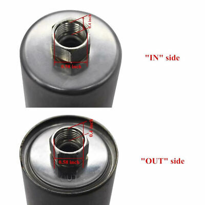

Any recommendations on which plugs to get, also what gap to run? I can pickup a MAP sensor, plugs, fuel filter no problem. I just bought some oil VR1 10-30. BTW the oil is ON SALE from NAPPA at $5.99 a qt vs $9.99 a qt, along with a nappa gold filter #1258. Looks like ACDelco fuel filter #25171792 I can pick up (running stock lines). Links below.
Fuel filter
