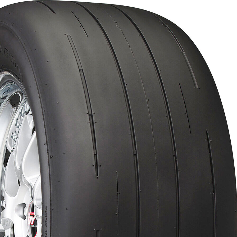

That 45/16 sidewall isn't helping you hook . Look closely at my sidewall after a run at BG . 1.45 - 60' . 275/60-15

Wow! So I guess this is why top fuel uses tires with so much sidewall huh? Never thought about the contact patch being elongated...just thought width was the only factor.
Yes, that's one reason I'm not such a fan of 275/50s. They don't flatten out as much even though they are wide.

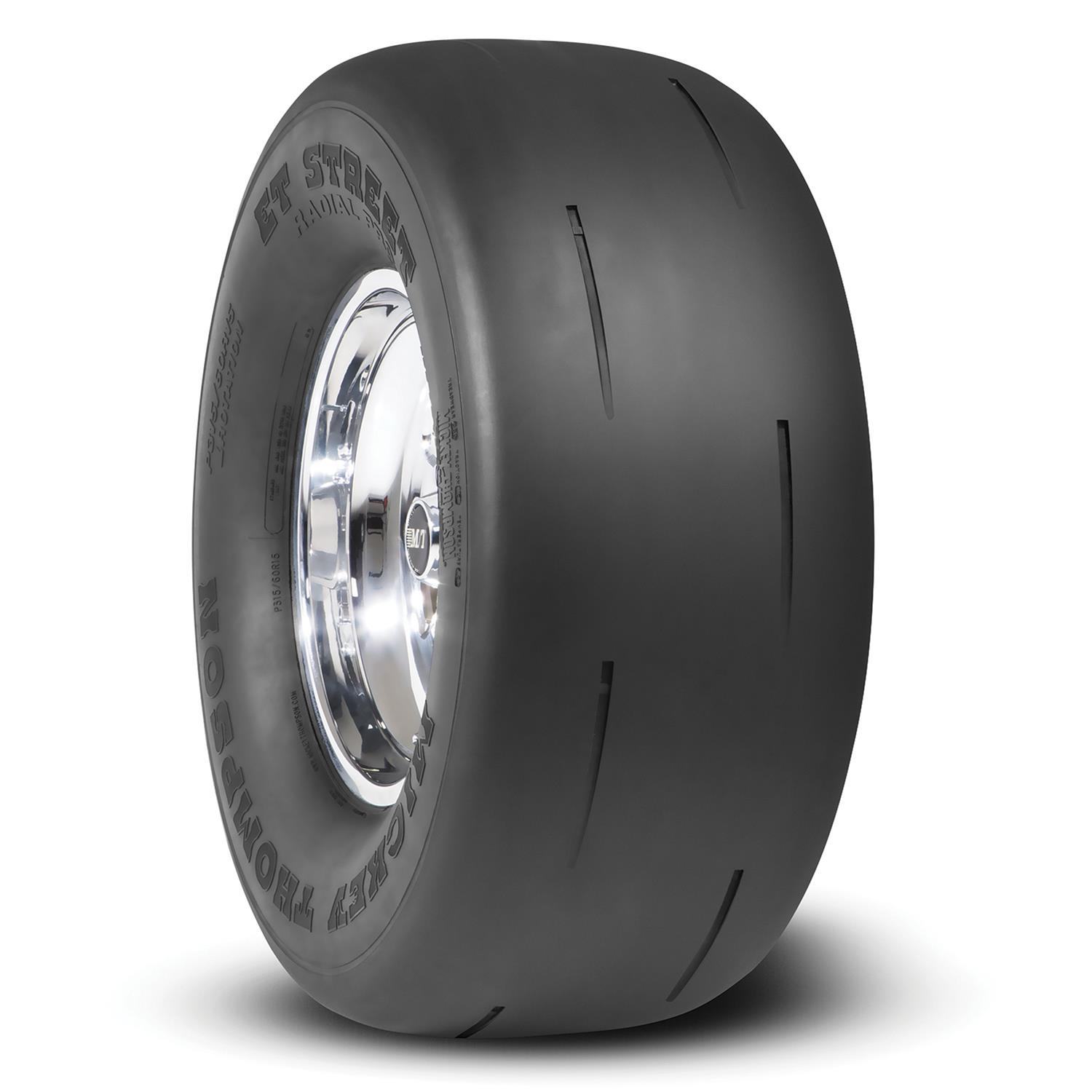

Just want to make sure this is the tire everyone is talking about before I get a pair. 275/60/15

thats the pro,the r tire in the same size can be driven legally on the road.if you just want it for the track then get the pro
This is the R, correct? They only time I'd drive on these is to/from the track. If I changed the tires at the track, I'd have nowhere to store the tires while I run the car as I go by myself.
Yes they drive nice!drive them to the track air them down and let it rip.
